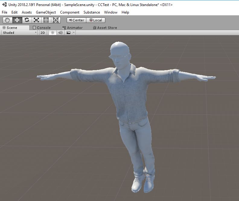

I followed the video and used the script to export a Game Base character with LOD from the CC trial version.
The prefab and materials were created but it looks like the textures are missing? (sorry, I'm new to 3d graphics).
Do I need to use the CC3 model or is it a problem with the trial version?
Hey! I would love to help you. Would be easier to chat through discord. If you are interested you can find me in here:
https://discord.gg/CkGjYN5
