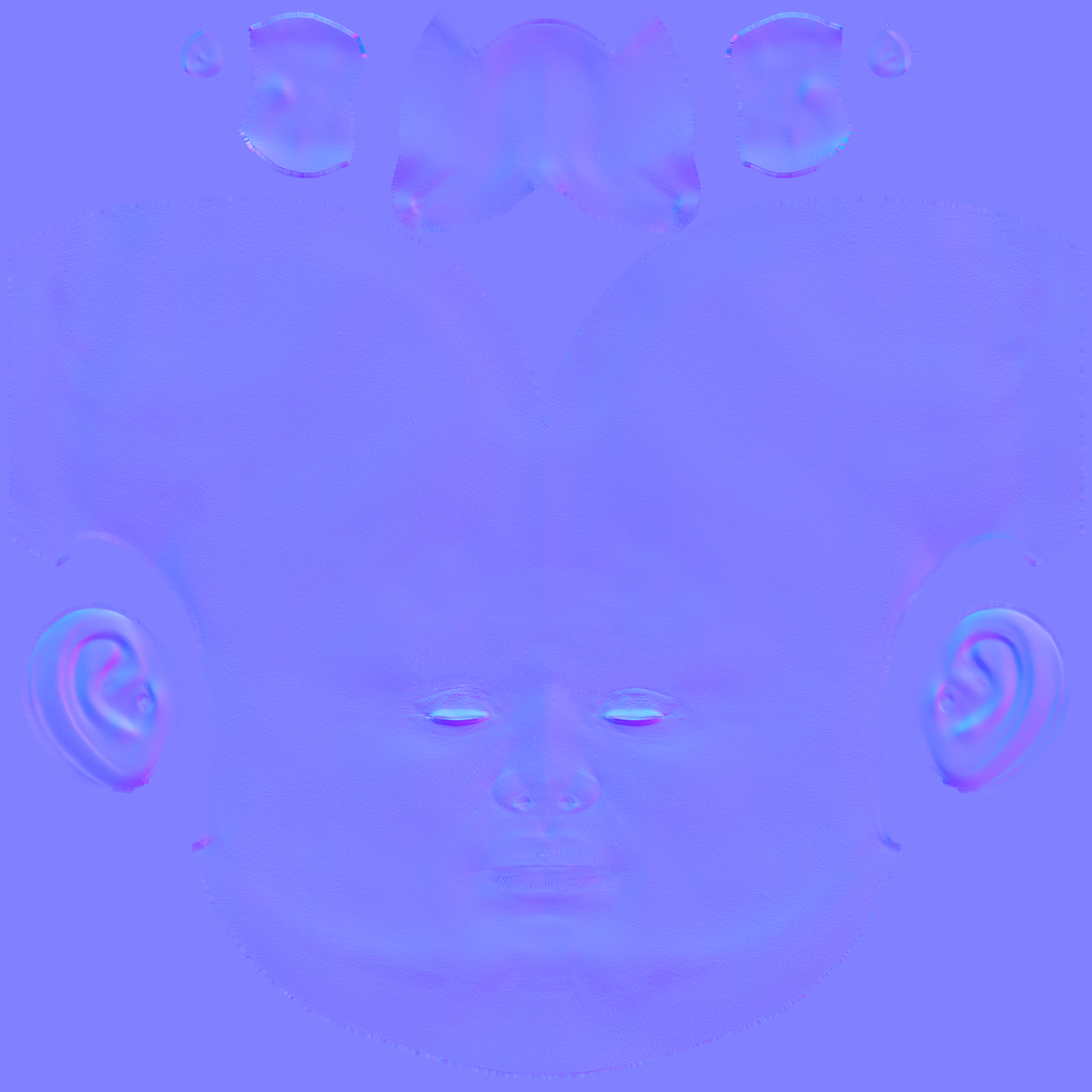

If you want to check your Normals to see if they're worth exporting, here's how you do it...
https://forum.reallusion.com/uploads/images/c36ab8e0-a7b9-4e65-a444-5590.png
First you need to find a map under the Surfaces tab; they're usually found under Template 2, but you'll also find them under Surfaces tab > Surfaces. Click on the map and choose Browse... then copy the location and open it outside of Daz to inspect the maps. We've already established that the CC_Base Normals are good, so we can use that as a basis for comparison...
https://forum.reallusion.com/uploads/images/31041f8f-05eb-4d47-843c-d5ab.jpg
As far as Daz Normals go, I've seen worse (by the way, I love this artist, I think she's great), but look at what I'm going to lose if I use this Normal. I'd lose all of the ear detail.
If you have Photoshop, what you can do in this case is use the CC Base Normal ear details instead. Ensure the maps are the same size. then use Modify > Material > Texture Settings > Launch Texture and drag the CC Normal into the document. Select the Rectangular Marquee Tool, right-click > Rasterize Smart Object, then make a rectangular selection around the ear, hold the Shift key, and do the other ear, then Select > Inverse (Shift+ Ctrl+ I) and Delete.

Your AO trick helped a bit but I also would love a normal or bump map for the face. For some reason, the one from Daz is making her face look off (both normal and bump do the same thing). Have you had this issue?
https://forum.reallusion.com/uploads/images/176e13ff-9add-4217-9219-bb24.png

So actually figured out that it was placing the lip cracks on the nose hint the weird crackle. The problemhttps://forum.reallusion.com/uploads/images/c0fb904f-4a10-45ea-a4b6-7765.png is fixed now when I made some edits to it in photoshop. I'm still wondering though does CC3 down convert from the amazing realistic IRay previews that Daz spits out? My dream is to have these characters look as realistic as possible with the easy rigging of CC3 so if anyone out there has made anything look close to human vs game character please lmk how you did it.
