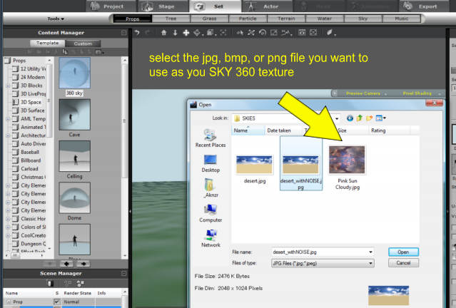

4) Click on DIFFUSE, then the OPEN icon and select the image you want to use for your sky

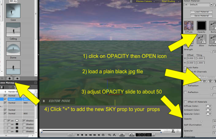

5) Now Click the OPEN icon again and this time click on OPACITY we'll add a plain black jpg. Adjust OPACITY strength slider to ~50 Why? because i want to create a SKY that is somewhat transparent. Why? becuase i will add another SKY prop, make it a bit bigger than the first one to become an outer sky - the transparency will help the camera see the outer sky prop. This way when i animate the sky prop it will look like i have layers of clouds
6) Now save the prop by clicking the "+" on the left panel. Now add this same prop to the scene. You should now have 2 360 SKY props on your content manager
7) Go to the transform section (top right section of the MODIFY section) and adjust the XYZ size of one of the SKY props to 115 - this becomes our outer sky layer

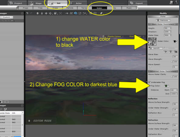

1) Back to our original project, to make it look like its night time,my first step is to adjust the color of the WATER
