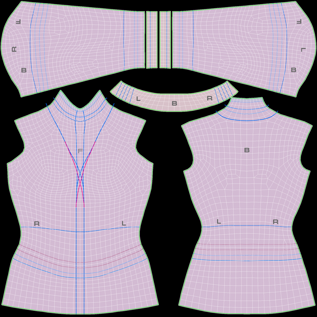

Mike, I understand your question. As I told this counter from "Project Info" inside iClone and if I'm not mistaken iClone calculate triangular polygons.
And of course I do not make any secrets from my UV (it visible in cloths templates as white hair lines) -- see attach to this post.
So these UV pictures also shows topology of cloths models in this collection.
Vit
