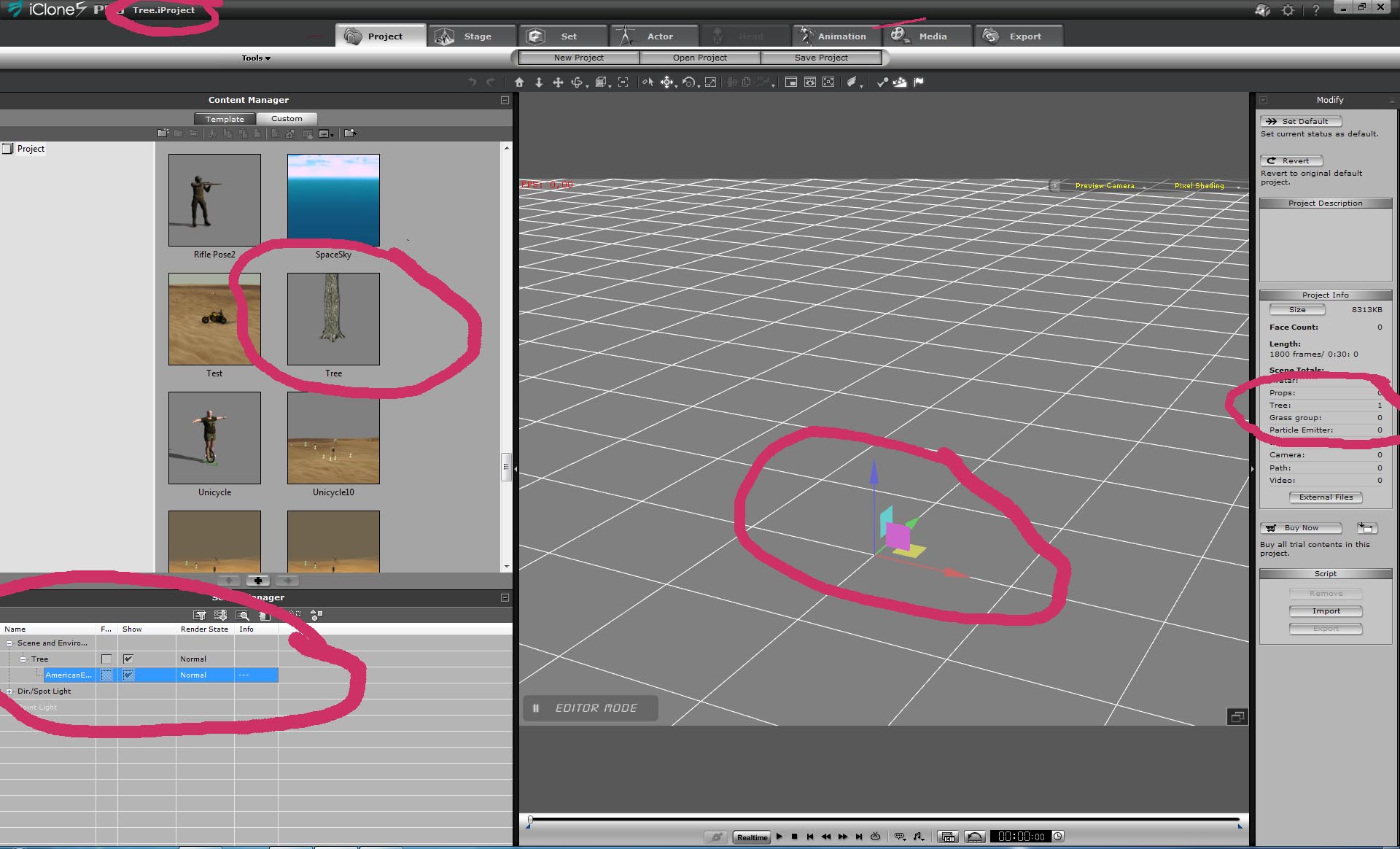

I've made 2 screenshots to show the problem and the parameters.

Lentamente (1/4/2015)
OK
1) Select "American Elm" in Content Manager & then Tool Bar Home Icon, to see if it shows.
2) If it does, Select any Object. Place that on the World Axis & Link American Elm to that. Select  "Position", in following Pop-up. If it then shows, un-link it & Delete the Object.

If it is a new project, it shows, as in any other cases. But once the project is saved and I reopen it, it dosn't show, even with the home button.
