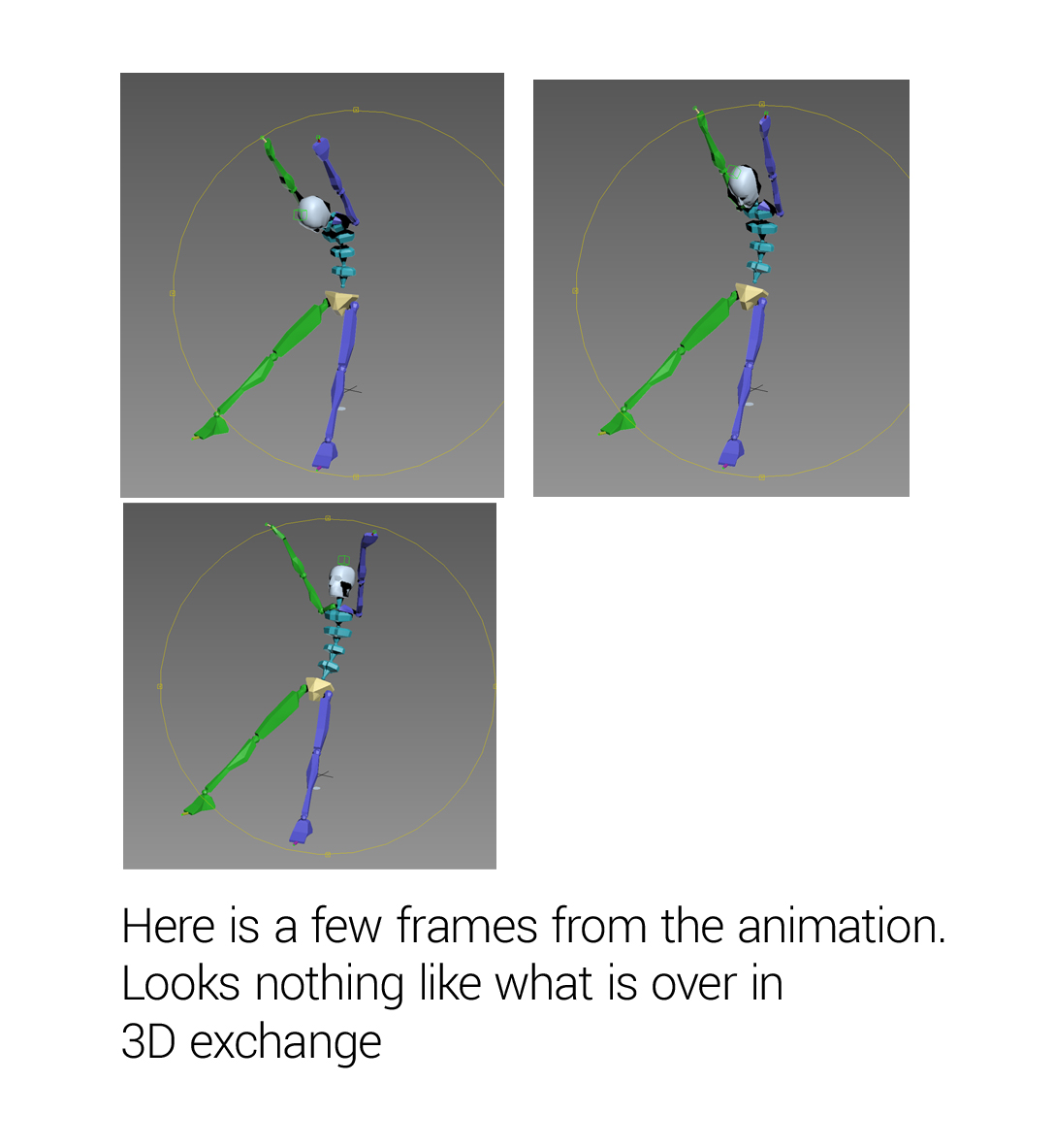

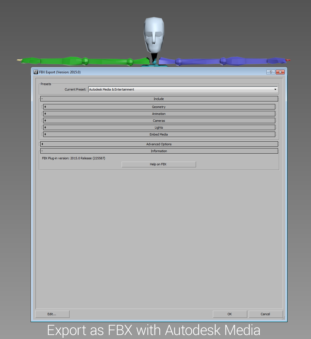

Thanks for the reply. First it is just a Biped no skin. How do you freeze the transform and rotation.
Here are some pics of the process

and the results in max

Your screenshot :
You can't export animation from 3dx5 without a minimum work inside max . Why ? 3dx5 change some joint orientation , add name and root ......
If you don't know how to make a freeze transform inside max , you have not the require knowlegde to work in animation inside 3dsmax .
And forget what have just said Sw0000p , because a biped (CS) don't need freeze transform . Sw0000p said that without knowing that you use one Biped from Character Studio ;) .
The best way for you is :
- export in fbx from 3dx5 with all the imotion you need
- import in max and work with this fbx file . Rig your model with this fbx file and now you can load all imotion ,using the first fbx export from max .
I hope it's clear

Thanks for the input. I figured it out. The scale was off coming out of 3D exchange. I exported it from 3dsmax as CM. When you import the mocap data back into 3dsmax the scale is either real small or really big.
Here is the fix.
1. Create a Biped in Max select only the bones not the footstep in your outliner.
2. Export FBX the usual way using Autodesk Media and Entertainment turn on bake animation or else you will get a bunch of errors in the export.
3. Import into 3D exchange add the bone mapping
4. Add what ever motion you want from Iclone
5. Export FBX from 3d exchange using m and uncheck rest scale
6. Back in max if you want to check just the mocap data choose add instead of add and update animation. This way you can see if your data lines up with the BiPed. If it does delete the data and re-import but use add and update.
Should be golden at this point.

Arms crossed because I did not have it in a Tpose when I exported it. The weirdness in the motions was when it came back in to 3dsmax. The scale of mocap data was different then what I exported.
I exported as CM in 3Dsmax and exported as CM from 3d exchange but it did not match. After I exported from 3d exchange using Meter the data lined up perfectly. Not sure why its not 1:1 between the software packages.
