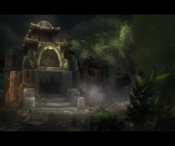

In particular, I'm looking for spooky fog and light settings, which can create scenes similar to the pics on this page by Bigboss:

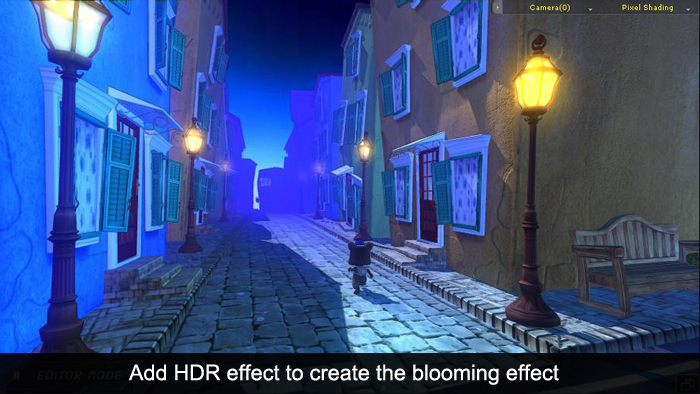

1) Toon fog, which is also handy with tips for general use & animation of IBL, HDR, lighting and fog settings:
52% of original size (was 979x35) - Click to enlarge
instructions at:
http://www.reallusion.com/ContentStore/iClone/pack/CityElements_Toon-Town/help1.aspxand this, which also uses the sky to help generate a nice foggy effect in the distance
