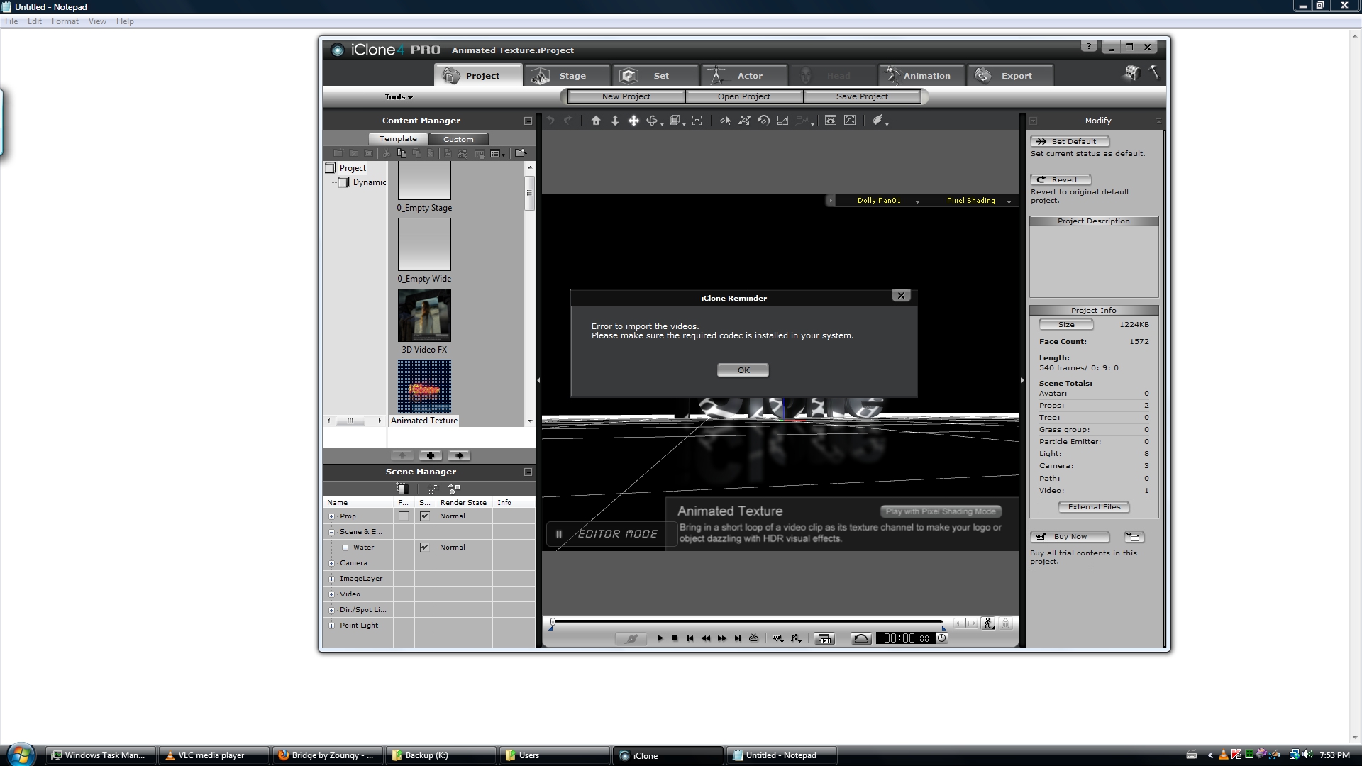

Hello,
I purchased most of the Reallusion software and installed it but I am have trouble with IClone 4 Pro. I installed Iclone 4 Pro first then the content but I am getting errors on screen even when i try a template. I am runniing Windows Vista Home Premium 64bit and UAC is disabled, and I have the show windows hidden files enabled so I can see all files.
I am attaching 2 screenshots of the a couple of the errors, the first says i am missing a codec and the other says it cant find the files. And yes it happens on every template as I tried them all.
For the screenshot the whole error does not show but it says:
"C:\Documents and Settings\All Users\Documents\Reallusion\Custom\iClone 4 Custom\Project\iClone 4 Project\Fire.avi"
For the path I don't have a C:\Documents and Settings\* on my at all not sure why it is trying to look there either.
I have only had the software just over a day and am totally new to it and to and 3D software.
any help would be greatly appreciated.

Hello,
1) Ok i did a full uninstall of the software then restarted.
2) I then installed IClone 4 Pro and noted the directories as C:\User\Public Documents\Reallusion listed for both directories.
3) restarted
4) Then I opened IClone 4 and an update shows so I installed the update.
5) restarted
6) opened IClone 4 Pro and tried templates, I still get errors depending on template and the error is similar on every template.
7) Downloaded K-lite mega pac both 32 and 64bit.
8) installed k-lite 32 bit mega pack & restarted
9) Opened IClone 4 and tried a template I still get Codec error and I still get the "C:\Documents and Settings\All Users\Documents\Reallusion\Custom\iClone 4 Custom\Project\iClone 4 Project\*****.avi "
10) Closed IClone and installed K-lite 64bit pack and then restarted.
11) Opened IClone and tried a template again. Still get both Codec error and the file path error.
12) closed IClone and Installed content again and then restarted.
13) opened IClone and tried again, and still get both errors.
I should also add I made sure my virus protection was disabled for each install as I always disable for known safe software on installs. Not sure what to do at this point as I am well versed in computers. Unless there is another method for Iclone to see the correct folder or content.
I went to the path listed on install and the files are all there and I have attached a screenshot of the path listed on install. So for some reason IClone 4 keeps looking for C:\Documents and Settings\All Users\Documents\Reallusion\ ****.
please let me know
Thanks in advance
Gren
EDIT: I also just tried clicking the 1-Click verification in IClone and it finished but still no change. Lots and Lots of errors/missing files acording to IClone 4. It keeps looking in the wrong spot for every template and throwing up missing file errors such as "C:\Documents and Settings\All Users\Documents\Reallusion\Share Templates\Video\3D Video FX.wmv

Hello,
Thanks for the replies and the help with my issue.
to make things more clear I uploaded a screen recording of the issues and put it on a test youtube account.
http://www.youtube.com/watch?v=VncRWhhbFaw
As for dragging in the items into IClone do you mean drag in the route folder where the templates are stored? If you watch the vid you will see what im talking about with the errors.
