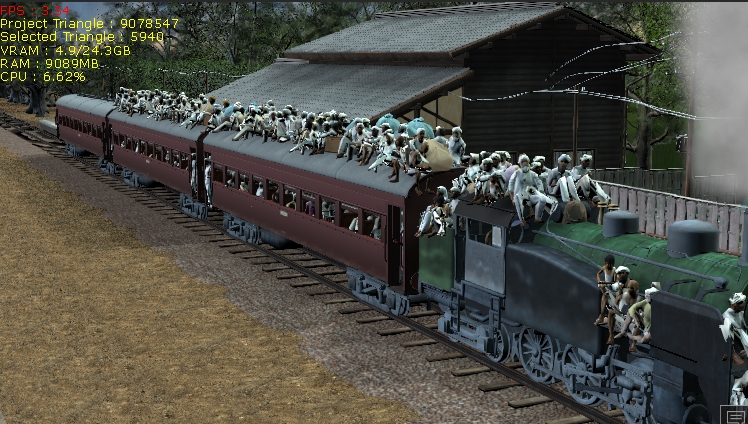

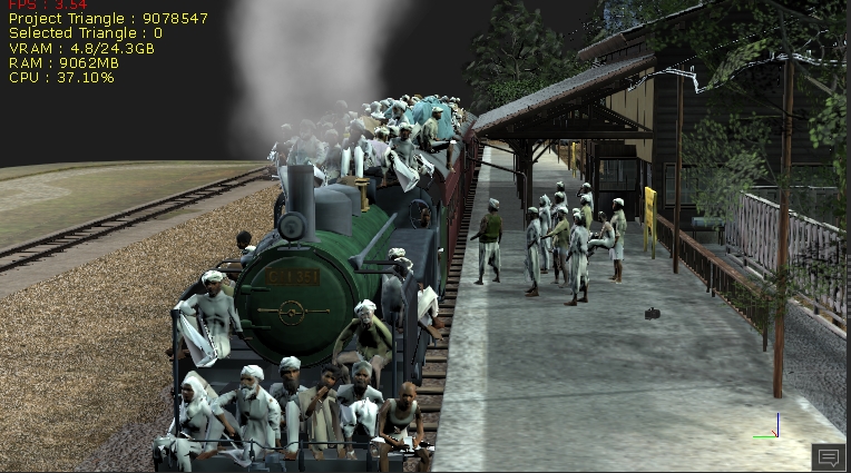

Hi,
Thanks for your reply and suggestions.
Unfortunately, my characters do not have accessories. They are all mainly clothed and accessories are converted to cloth.
Please see the screenshots attached. It is a train scene with lots of people on it.
The issue I have is my scene has a crowd of characters. And I think when I added a certain type of character, the problem arises.
It las happened when I added two different characters to the platform people. So, I will check new characters before adding them for accessories. But I think the problem is not just accessories associated.
Not sure if it an LOD remeshing issue or something else?
Either way RL need to get a fix to this asap as it is a very difficult and appalling problem that has cost me days and put huge pressure on my deadline.
If I had known, I would've just used iClone 7 for this project.
Regards,
Sam

I see bearded characters in your screenshots. I would test those avatars out first, and see if the hair elements may be causing the same problem as the accessories.

Thanks for the heads up on the beard. But I've noticed the bearded characters do not seem to cause any issues. They load okay.
There must be something that is related to something being classed as an accessory that maybe is not an accessory as we know it.
I am trying character by character against the mass of characters that do work. To find out which characters are problematic.
