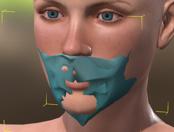

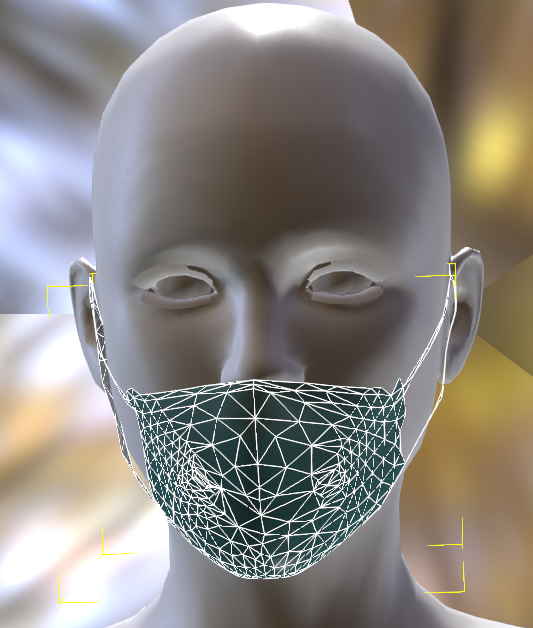

Hey guys,
don't know it's on me or its a bug, here my problem:
i create a mask in c4d and try to import it. Everithing works well but, when i save the mask as a costum cloth part and then open up another model and attach it, the mask is not like i import it.
It seems that the triangle decimated, so that the quality is bad, see the pics.
What i do:
1. Export standart women without motions and cloth into fbx
2. Load it in c4d and add my mask, position it and bind it to head bone
3. Export from c4d to fbx
4. Import it to CC2 newest version
5. select mask and add it to costum
6. Open new or my character and add try to attach. See result.
Are any know issues with this, or a maximum of triangle or file size for cloth parts?
Thanks,
Sam

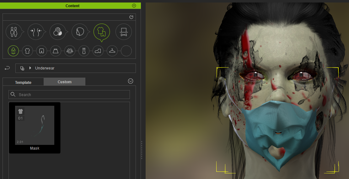

Hey Rampa,
thanks for helping... The hint was a good one, but no, i can use it on every character, included the character i used to export / import it. See pic...
After saving it to custom it's broken. I also try to import / export it with the original character. Also tryed closing and reopen cc2.
The morphs change a bit but not effecting the problem.
Seem to be hard to find the problem. Btw, i use the CC_Base_Head bone to bind.
Bests Sam

Got it, thank you!
The trick was to set the checkbox (Lightwave / Cinema4D compatible) while exporting from cc2 to fbx.
Then also the character looks good in c4d. Everything is working like charm now. Also the preview of the mesh looking right now.
Thanks and cya :)
