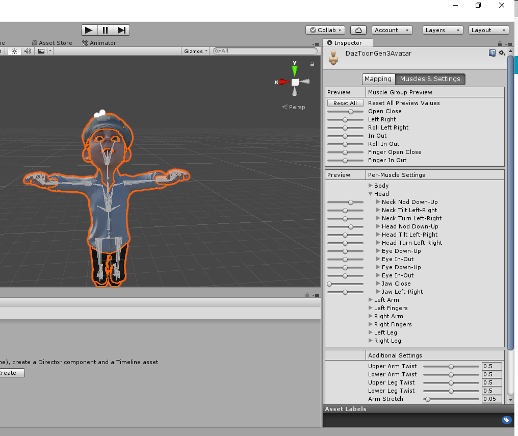

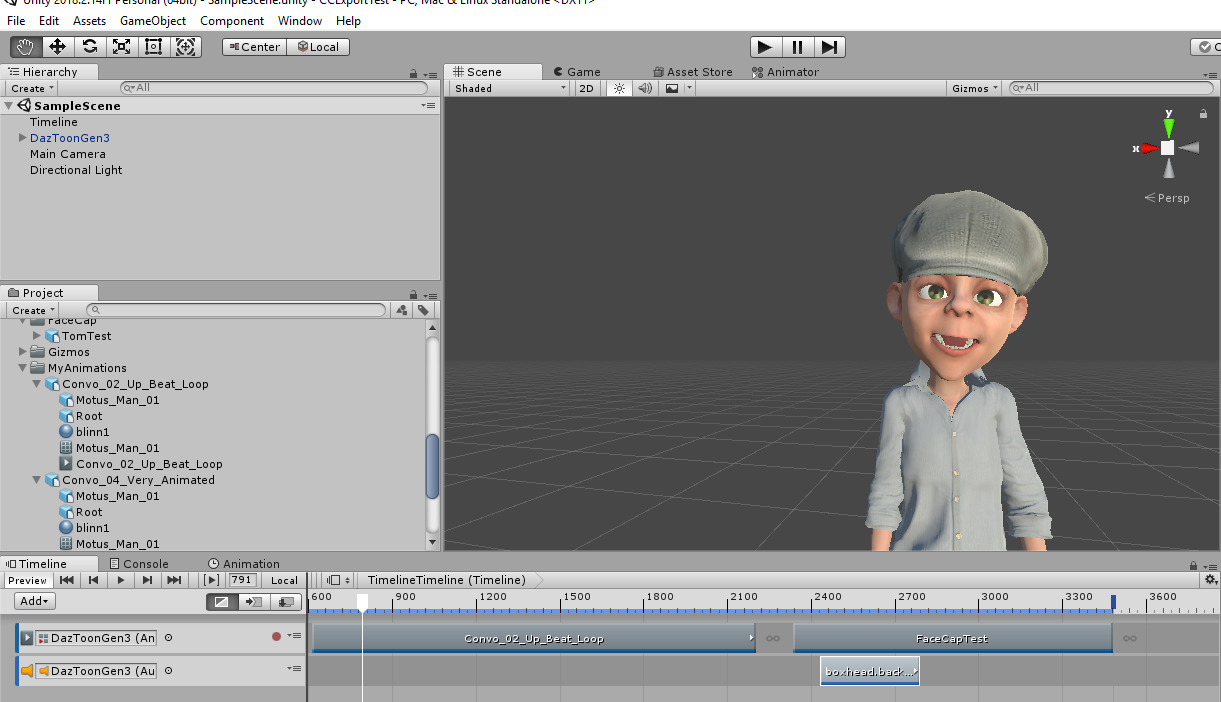

My new challenge is that with applying an animation, the character has it's mouth hanging open. See attached file "MouthOpenBug"
My animation works with other imported Unity characters but not Gen 3 or 8 - it leaves the mouth open. When I go to configure the CC_Base_JawRoot to another bone - after I click Done & Apply - it reverts back to the CC_Base_JawRoot?! (see image)  When I go to Muscles & Settings, I can use the Open close slide bar under Muscle Group Preview and but when I try to close the mouth using Jaw Close under the Per-Muscle Setting - nothing happens?! (see image).

I've had that "mouth open" problem in Unity with a variety of 3D figured (DAZ, Mixamo, Reallusion) and different character rigs (Unity, Invector, Ootii 3rd-person controllers). I used to be able to fix it by editing the face bones in Unity and selecting "none" for the jaw bone. That stopped working recently for some reason, maybe in Unity 2018.2 or 2018.3. I finally got sick of it and edited all my animation files. I looked at the animations in Unity from the drop-down menu WIndow > Animation > Animation and "Animator.Jaw Close" = 0 on all my offending animations. I have to change the start and end points to equal 1. The only problem is most animations are read-only, so I have to find the correct animation (easier on a new project as there aren't 25 Idle and Run animations), select it, and copy it with control-D (command-D on Mac) then rename it to something like Jaw-Idle or Jaw-Run. Then I make Animator.Jaw Close = 1 and then drag that into the Animator motion parameters to replace the old one. On the plus side, I added an "out of breath" idle pose after a sprint with the mouth opening and closing.

It's a bit of a strange one this. The default in Unity is 0 and when you look at the jaw this equals to a half open mouth. So you have to edit your read-only animations and set the Animator.Jaw Close = 1, like previously stated by thanatopsis.

We'd like to clarify if this is the case you encountered.
https://forum.reallusion.com/uploads/images/56b60183-f0a6-4288-a5dc-9731.png
There is no motion file exported along with FBX file, which means there is no animation in the Animation Controller. When clicking play, we will see this result.
If this is the case you encounter, you can manually delete the Animation Controller, or add animation.
