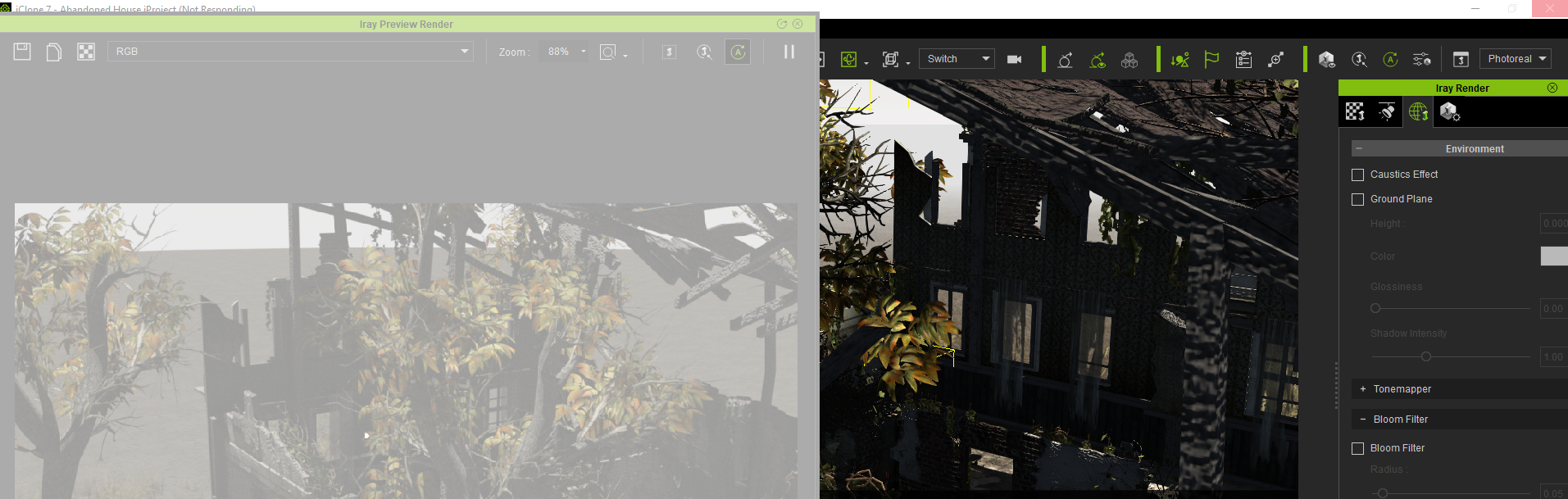

Not sure If I am missing something
But  I have an Nvidia 1070 GTX   and 64 Gb PC Memory
When I load an example project, and do preview rendering,  it takes forever...  it's been 10 minutes  and only 470 out of 1000 done
So I changed it to 200,  but still taking forever.
When i watched Kai's video it takes seconds... so  what am I missing here for the preview render?
Looking at the screen it uses the GPU and CPU for it.

another issue is,  every time i try to move the camera,    Iclone keeps Freezing up when I have the Iray preview up

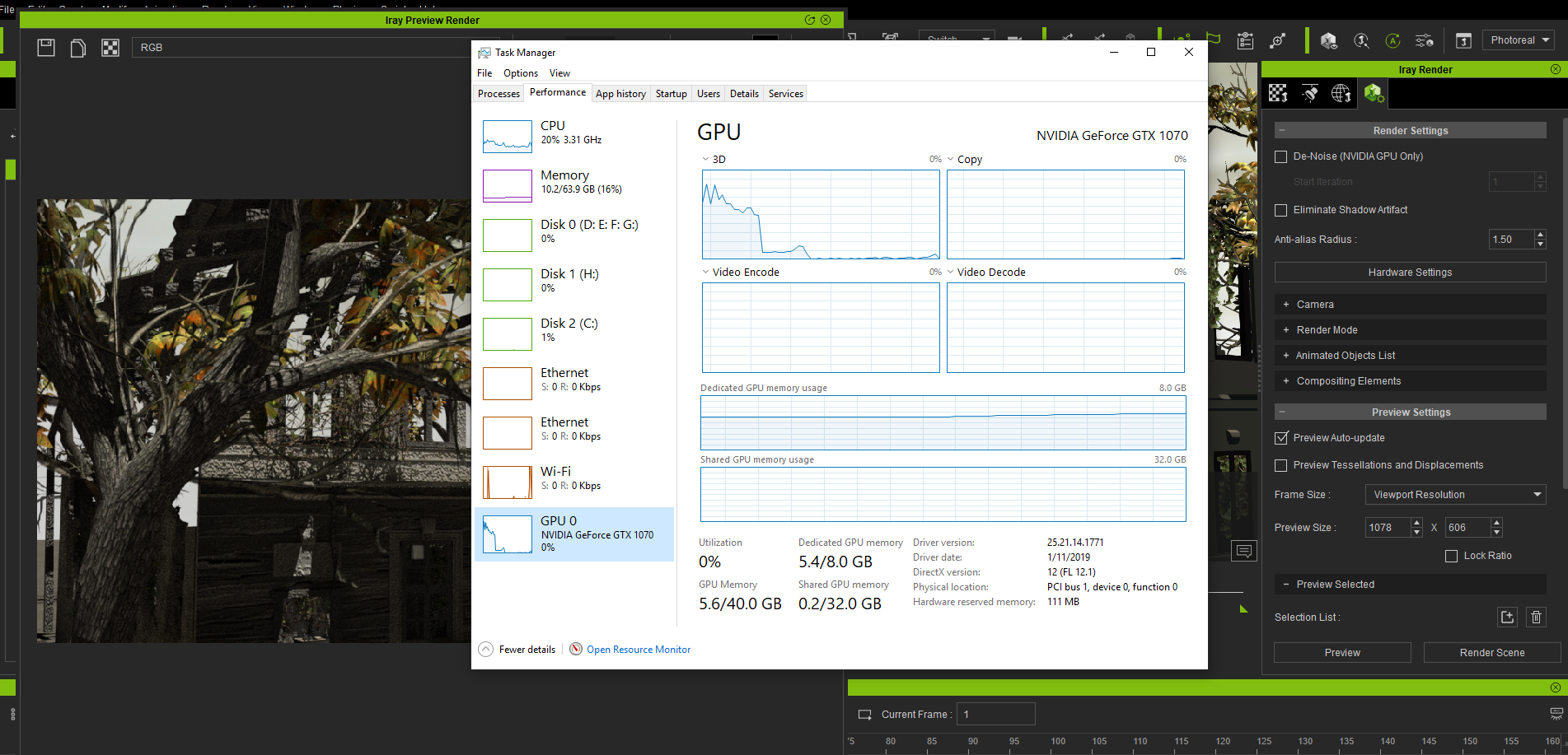

I checked the video, and setup like that as well.
It still takes forever..  every little move and it takes minutes before i can do something
Iclone keeps freezing up for a while, and then it does something.
Set the count to 150, and it still takes about 4-5 minutes.
idk why it takes so long.

I load the project  and it's processing,  5 Gb is used out of 8  .  (in the main viewer it's using 0.5 Gb)
