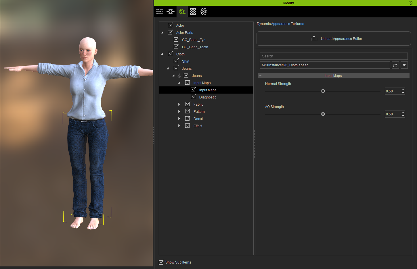

It's not in CC 2.0 for the default assets at least, are you sure? There is no RGB slot as far as I can find. :-/ I followed the CC video turorial to it, and it just doesn't exist as a slot. Please reference my CC screen, and the documentation screenshot with the RGB slot.
https://forum.reallusion.com/uploads/images/60f67a3f-3756-4f3b-822d-f4d2.png
https://forum.reallusion.com/uploads/images/73c84b2d-4939-4cc4-8fed-0240.png
https://forum.reallusion.com/uploads/images/d18dc75e-2d09-443b-b3a4-519b.jpg

Yeah, I see what you are doing, don't dig so deep into that hierarchy, go to the top level of the Jeans, you'll (hopefully) see all the controls, including the input maps and diagnostics.  That said, I still see the input maps for all the clothes, including the jeans, at that level, so that may still be an issue, I dunno. Maybe it is your install?

eternityblue (1/15/2017)
I can't find it for the life of me. I am learning substance now, it's a nice format, but I'm losing my mind trying to figure out if I'm losing my mind. All of the fabrics show up, but not where to import the RGB map itself.
If you can confirm it's in 2.0  for sure, that would be great.
https://forum.reallusion.com/uploads/images/4e7f9c27-e765-452e-89ff-9119.png
https://forum.reallusion.com/uploads/images/bc2fd397-52dd-42a4-ab05-3ba2.png

Nadiak, I think you need to move your installed content over from CC1.5. You only get the input maps when the "Essential" packs are installed.
The paths to copy should be in the original CC2 post from RL.

aha, now I see why I get them now. I was checking the RGB mask when I got CC 2 but just before I installed the essential pack into CC2.
Gee wiz. All this time I was thinking along the workflow I mentioned when in actual fact it was  installing the essentials pack. I had forgotten that requirement.
