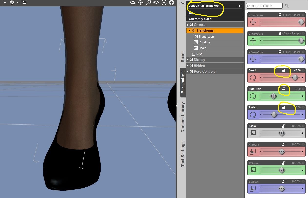

Just in case anyone still has problems with this and would like to take care of it all on the DAZ side before 3dx5 I hope the following images will help.
Before exporting your character from DAZ as an .fbx file select the right or left foot, in parameters lock the bend, side-side, and twist sliders.  Do the same for the toes and big toe. Repeat for opposite foot.
Next select the right or left high heel shoe, in parameters lock the X rotate, Y rotate, and Z rotate sliders.  Repeat for opposite shoe.
Nothing is necessary in 3dXchange.  When the character is applied to iclone it works fine.  The third photo shows the heels during the Gwynn walk motion.
Hope this helps!

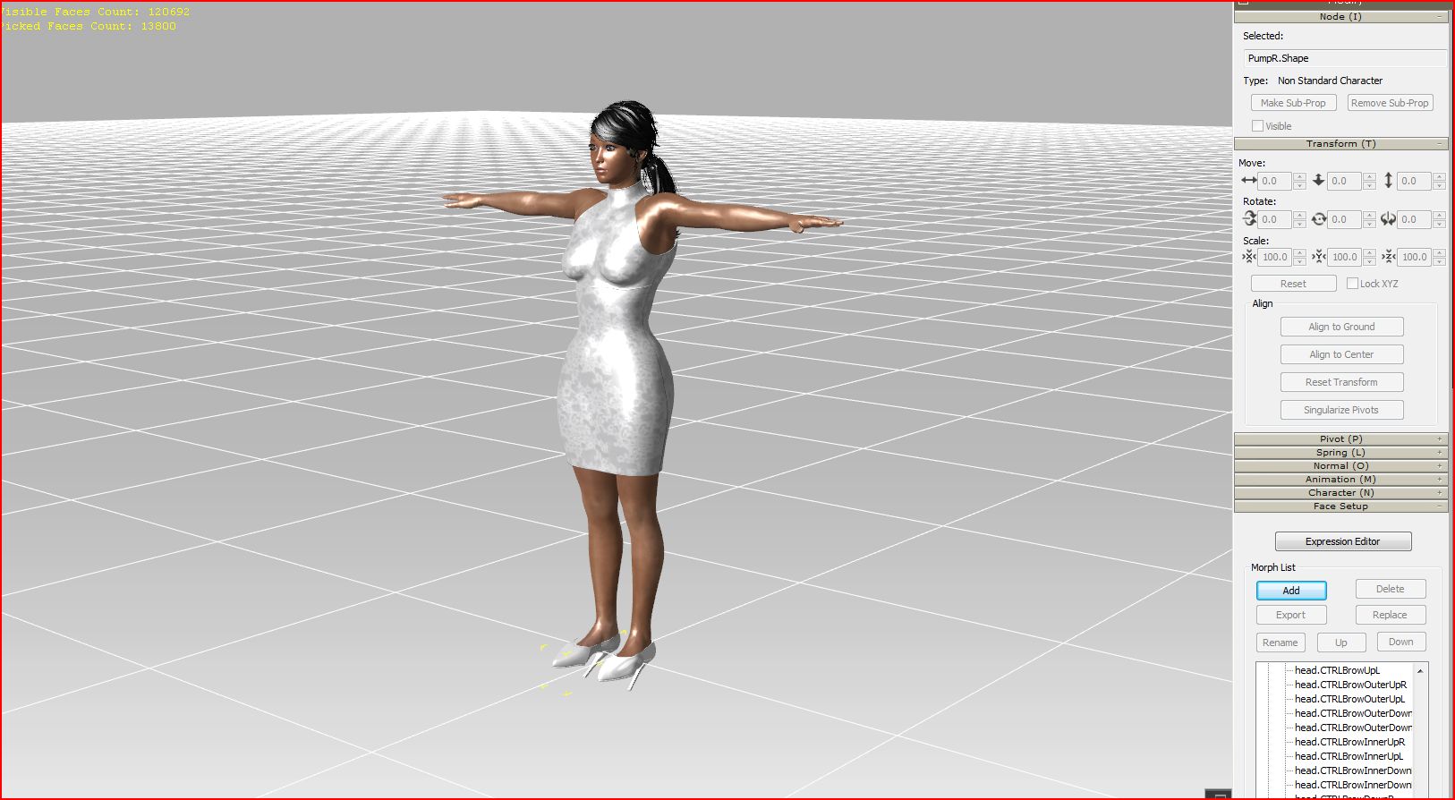

Thank you Majorlance I have been experimenting for a long time with this, but it never occurred to me to fix things on the Daz end. You guys in this forum are a wealth of information for a guy like me. I am going to post the results that I got by following your advice just in case anyone has any doubts about this. Guys this works great, once again thank you very much.
