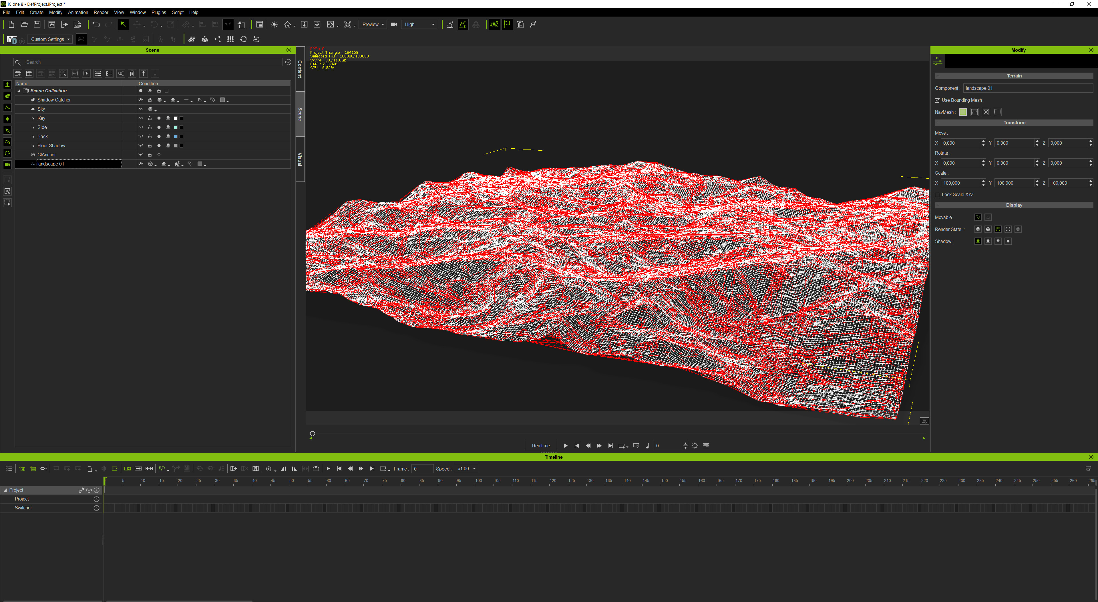

While this not something I would normally need, I tested this with a small landscape. The process finished, but I'm not sure how long it took, since I was surfing the net while iClone was doing its thing. I'm guessing the red lines have something to do with collision detection.
NB: I'm adding the screenshot as an attachment so that the forum software won't reduce the resolution.
