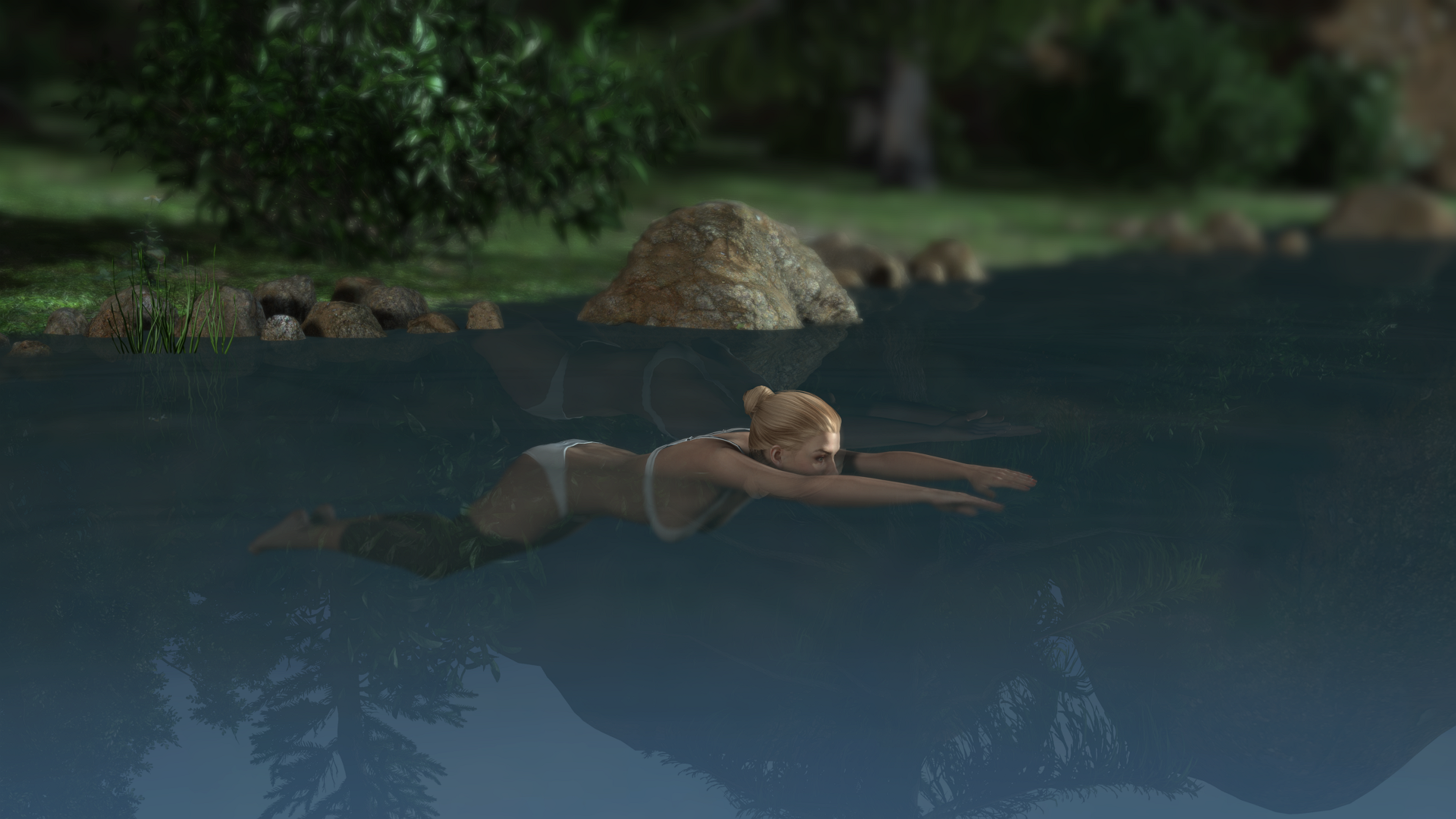

I'm currently trying to animate someone swimming. Once the character is in the water it reflects a very odd upside down reflection above them as in the picture attached. I've tried adjusting everything but the only thing that gets rid of it is reflection at zero which obviously is not  great. any help or settings would be much appreciated. Thanks.

Water prop does not "like" Subdivision nor Tessellation when character is submerged. Switch to Original and odd, double reflection would be gone.
For outfit it's sort of an opposite. For bra and panties leave it as subdivided.
Character is Subdivided, outfit is Subdivided
https://forum.reallusion.com/uploads/images/5e291471-b147-42ec-bc88-4761.jpg
Character is Subdivided, outfit is Original (looks like this is how you currently have it in your project)
https://forum.reallusion.com/uploads/images/45cf5f3f-a8ec-45c7-a4f5-dc57.jpg
Character is Original, Outfit is Original
https://forum.reallusion.com/uploads/images/cd29d3c5-8daa-414d-8c5b-a7f8.jpg
Character is Original, Outfit is Subdivided (best)
https://forum.reallusion.com/uploads/images/f69ccd1b-a1c7-48f4-aa16-06ec.jpg
Update: I have noticed the bra and panties I used had a Displacement map. If I delete that map, the Original setting has to be used for outfit as well.
Still, the reflection is not 100% accurate, when character is half submerged into the water. Teeth could be seen in the reflection at some camera angles.
So you have to play with water settings and camera angles for the best visual as well.

You are a life saver! I'm not sure how the hell you found this out but I'm glad you did. I've spent about 4 days trying to get rid of it but didn't even think changing the meshes would make a difference. Thought I would have to leave this scene out.
