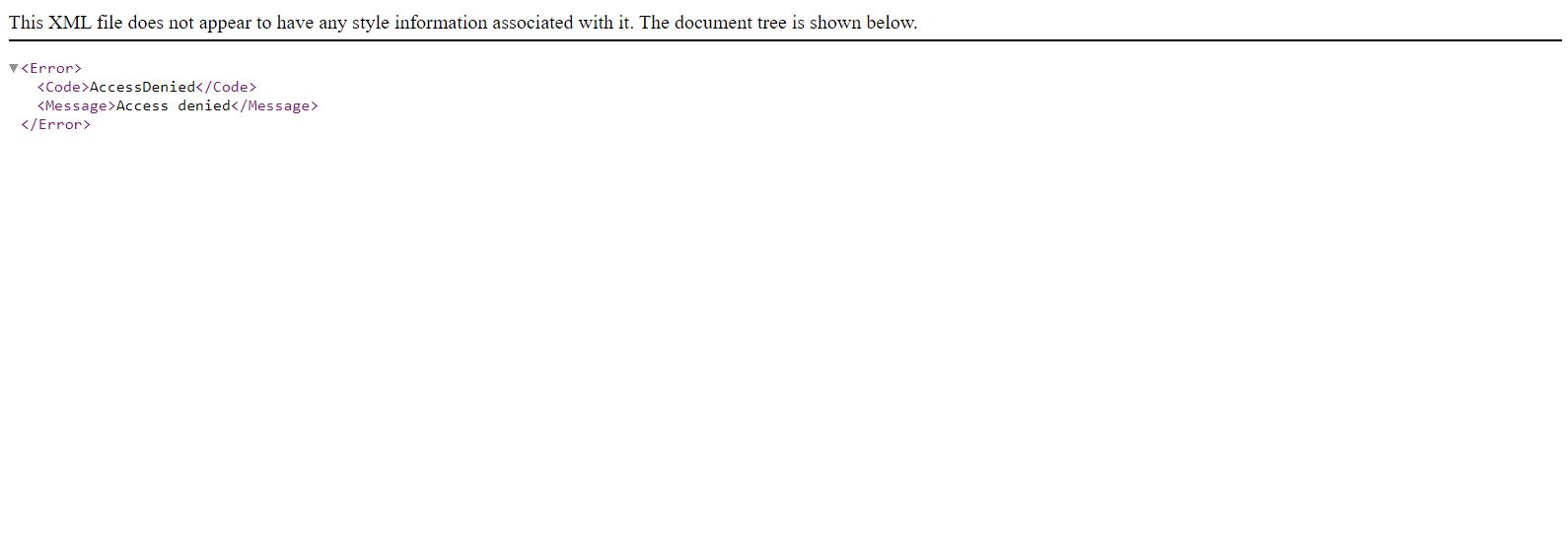

Now When I try download the motion clips using the clients account, it gives me an error message, please find attached. Can someone please assist us.
