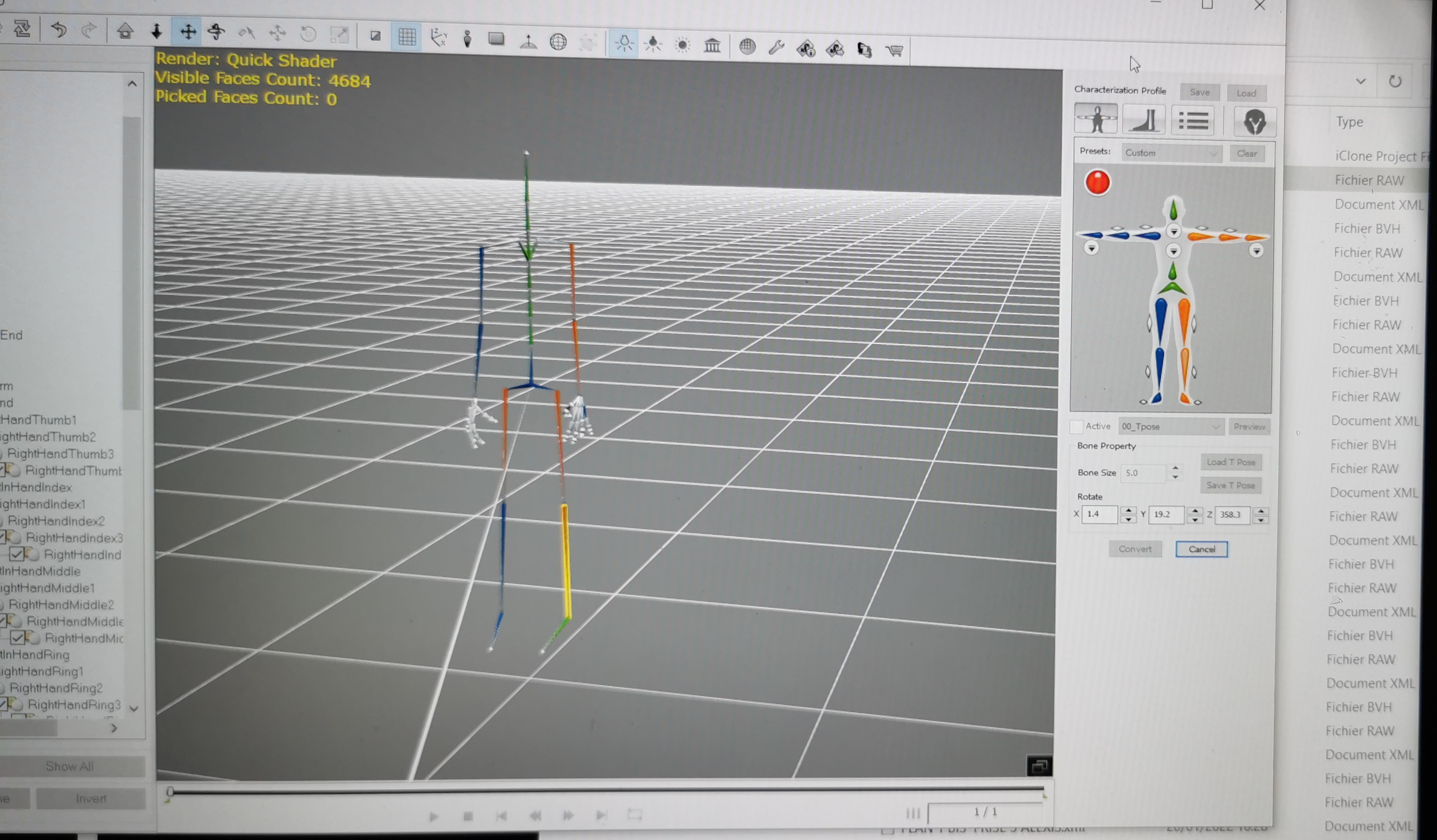

Thank you.We tried to follow the procedure, but it doesn't work, we are very quickly blocked with grayed out parts that cannot be modified. See attached image with red button and not green.
I am also attaching the RAW file in case someone can verify.
Thanks for your help....

From the screenshot I see you are missing bones and some are incorrectly assigned. (BTW, you do not have to attach images, you will quickly run out of space - 10MB is a limit. You need to post them in Editor directly with Insert button). First, you have to map bone in T-pose only. I have a routine for gathering a T-pose from BVH files here: https://forum.reallusion.com/FindPost500970.aspxThen go through through manual pages again and practice with bones mapping. This one has fairly straightforward skeleton bones structure (compare to some others I have seen). Finger are a bit messed up in the motion file, you'd have to fix it in iClone. I've attached 3DX and T-Pose profiles for your motion files anyway.

We managed to convert but it's not great. When you say that some bones are missing and that some have badly assigned, can you tell us how to rectify that? Is it a pre-adjustment on axis? Once the capture is made, can we still fix it or not? Thank you for your precious help.Oh no, I meant the screenshot you posted with bones assignment in 3DX. Head, Clavicles and Hands were not assigned and legs bones are not properly assigned. But the profile I have attached should fix that. I do not have much experience with neuron suite (I have it, but it's mostly collecting dust lol) The problem with AXIS seams as if it's hard to calibrate fingers, specially the thumb. I remember I had lots of problem with that and finally gave up. The same thing I see with motion you posted, some fingers are twisted badly. So some cleanup is due. Or you may scrap all fingers motions (literally sample the clip and remove fingers keys) and then maybe try free Hand Gesture Puppeteering plugin: https://www.youtube.com/watch?v=VOEnVM2TlMw
