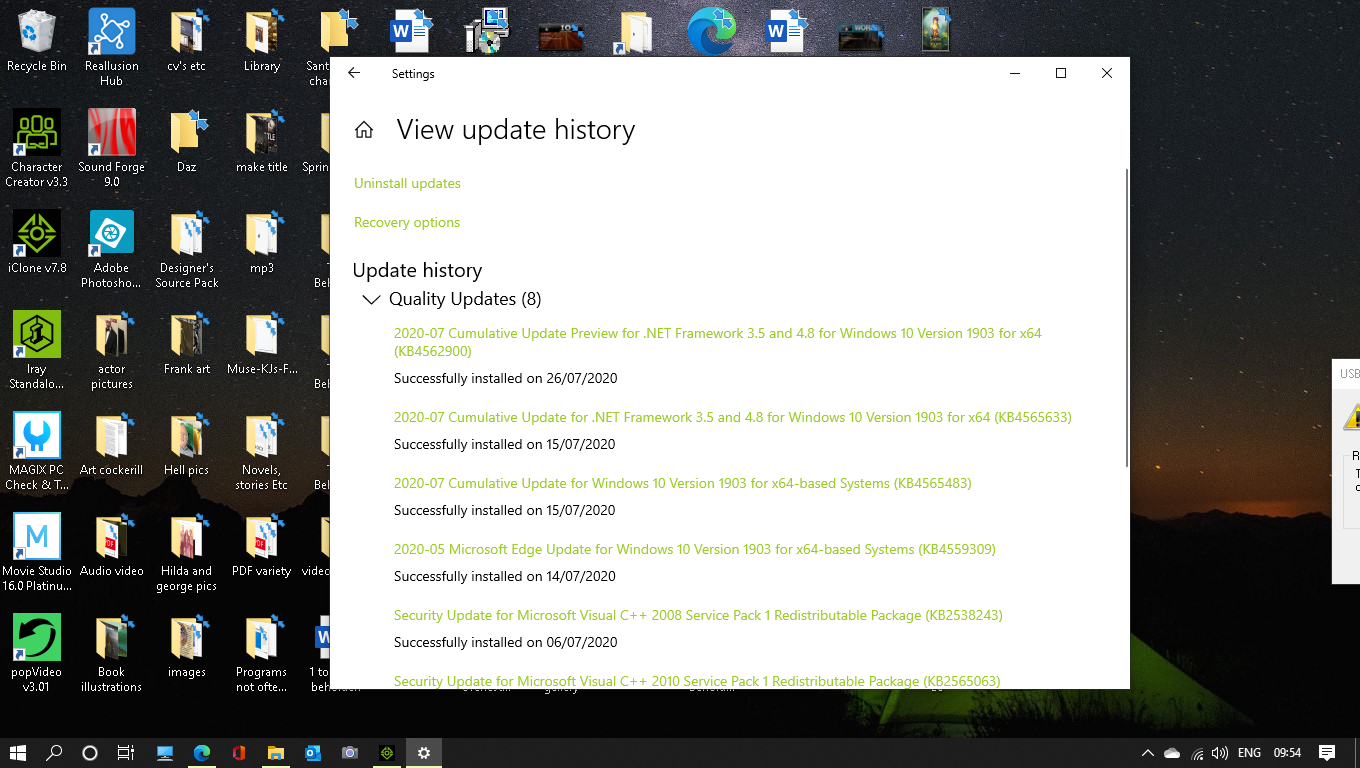

I received this message. "Failed to locate the iClone custom folder. The path is J:\Users\Public\Documents\Reallusion\Custom\iClone 7 custom. Please make sure you have the rights to access this folder and that the file exists."
The drive I have all the contents of iClone on is my 'J drive.'...This happened after I updated Windows (see attached screenshot)
After having problems, I switched off iClone 7 and restarted Windows, then tried to open iClone 7, which is when I received the error message...
After trying everything I could think of, I started to check my computer, which is when I discovered my 'K' drive had disappeared and my "J" drive (which has all my iClone content) had been given the drive letter "K". (which is why the computer can't find the content)...  I then tried to change the drive letter back to "J" which is when I discovered the drive letter "J" had also disappeared...
So I'm now at the point (after viewing my Windows update history) where I wonder whether I should cross my fingers and uninstall the Windows update!
I'm not going to make any decision until after 1300 hours BST today, (28/07/2020, this is when my stepson (a computer expert) will do a remote viewing of my computer. I definitely do not want to have to reload all my programmes again... If anybody else has any other suggestions I would be very grateful.
