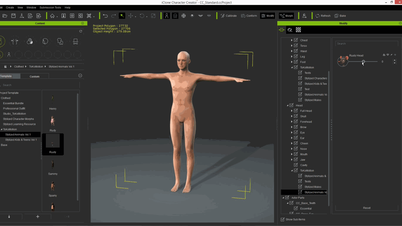

If someone can point me out a tutorial to create a morph slider only for Head from a morphed character will be very welcome. I'm trying to do it but the result in that the all body morphs even I select Head part in the menu...

Thank you Postfrosh. But I knew it works when you create morphs in CC but I would like to have only this Head morph from this default character:
https://forum.reallusion.com/uploads/images/05a7a342-4318-4336-9588-8cbf.jpg
I think because you can't export only the head I presume....

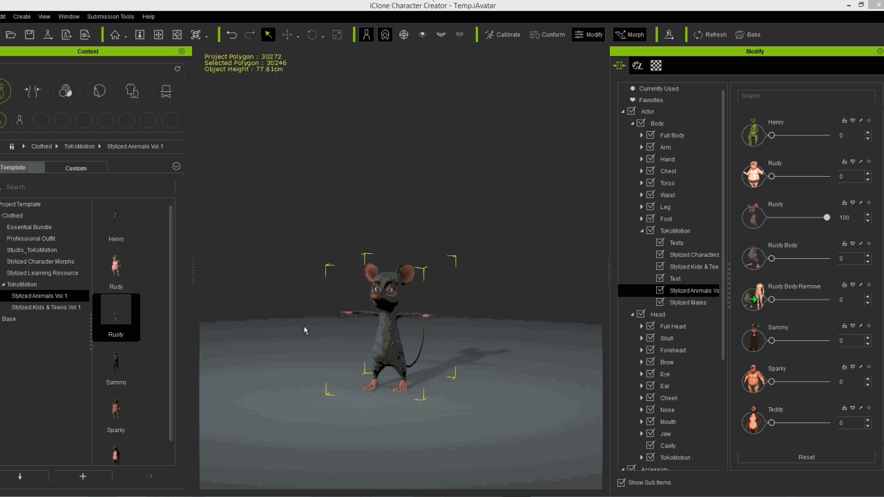

Hi Marc.
I was wracking my head about this very long and after I saw this new Topic from you I was thinking hard again ... and what shall I say - the solution is really easy:w00t::
1. Send the character to iClone.
2. Save the head as a custom head in the AVATAR/ACTOR/HEAD section.
3. Load the Default Character in CC (or any other character).
4. Send this character to iClone.
5. Apply the saved head to the character.
That's it! You can send the character back to CC then and apply additional body morphs etc.
Hope that helps.
