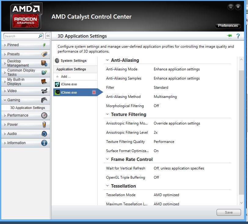

I have a Lenovo G505 laptop running Windows 8.1 and I installed the latest AMD Catalyst Control Center which included all the driver updates, the AMD settings they show at the above site are a little outdated, so here's a pic of how I set up mine in case someone else has the same set up. I have seen a big difference in the way iC6 operates!
NOTE... The AMD installer adds a couple of things you may or may not want, I uninstalled the stupid game site program and a Google Chrome extension and all is good now!
