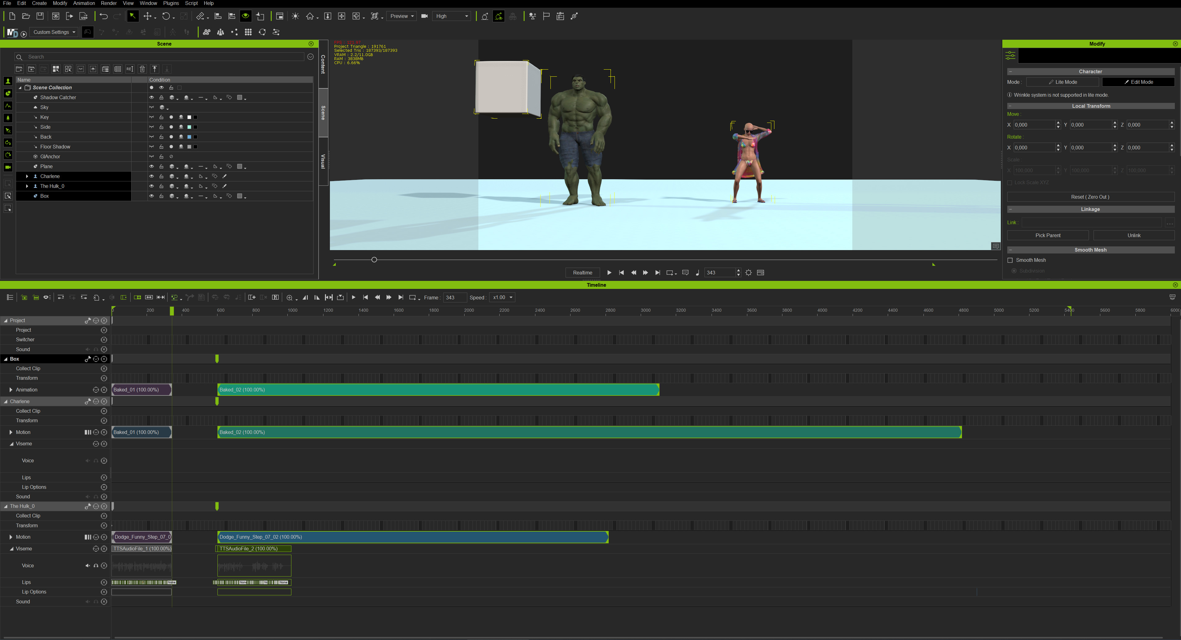

The OP's question was not, as I understood it, whether it is possible to tweak the timing, etc. on the level of an individual animation layer, but how to easily (!) move around a ton of animation layers for character animation, camera motion, dialogue/audio, facial animation, lighting, etc. all at once by, say 120 frames, to the right from the current play-head position. Is that something iClone can easily do (without having to flatten animation clips/tracks, breaking up individual layers/motion clips, and so on)?
[Quite a number of moments later...]
After some testing I can answer my own question: yes, it seems possible, but IMO not all that easily and it also seems to require prep work (such as flattening animations into clips, which the OP does not want to do):
I set up a small test scene with a a female dancer, an animated Hulk character and a simple box moving around a little (that animation needed to be flattened). I also gave the Hulk a few words to say via TTS. Then I selected everything animated, cut up all layers with with just one "break" command (i.e. one mouse click) and moved everything some frames to the right (see screenshot). NB: I did not test this with camera moves, lighting changes, the camera switcher, etc. because I'm not familiar with these things in iClone since I do all that in C4D.
iClone even cut up and moved the audio file and viseme track. To be frank, I had not expected that; iClone surprised me, so kudos to Reallusion.

NB: the screenshot is an attachment because of the resolution.
