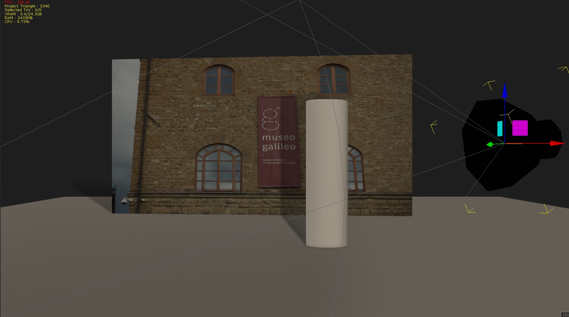

it's a pity I wasn't successful. I probably made a mistake or misunderstood something. My test setup:
Horizontal plane as floor, vertical plane 16:9 with an image, cylinder as moving object (later), spot shadow caster.
Your suggestion 1: The shadow of the cylinder is cast on the vertical plane; the cylinder does not receive an image section as would be the case with a beamer.; nsert the image as a texture of the cylinder; the UV adjustment would be extremely complex for a moving cylinder (screenshots #1 & #2)

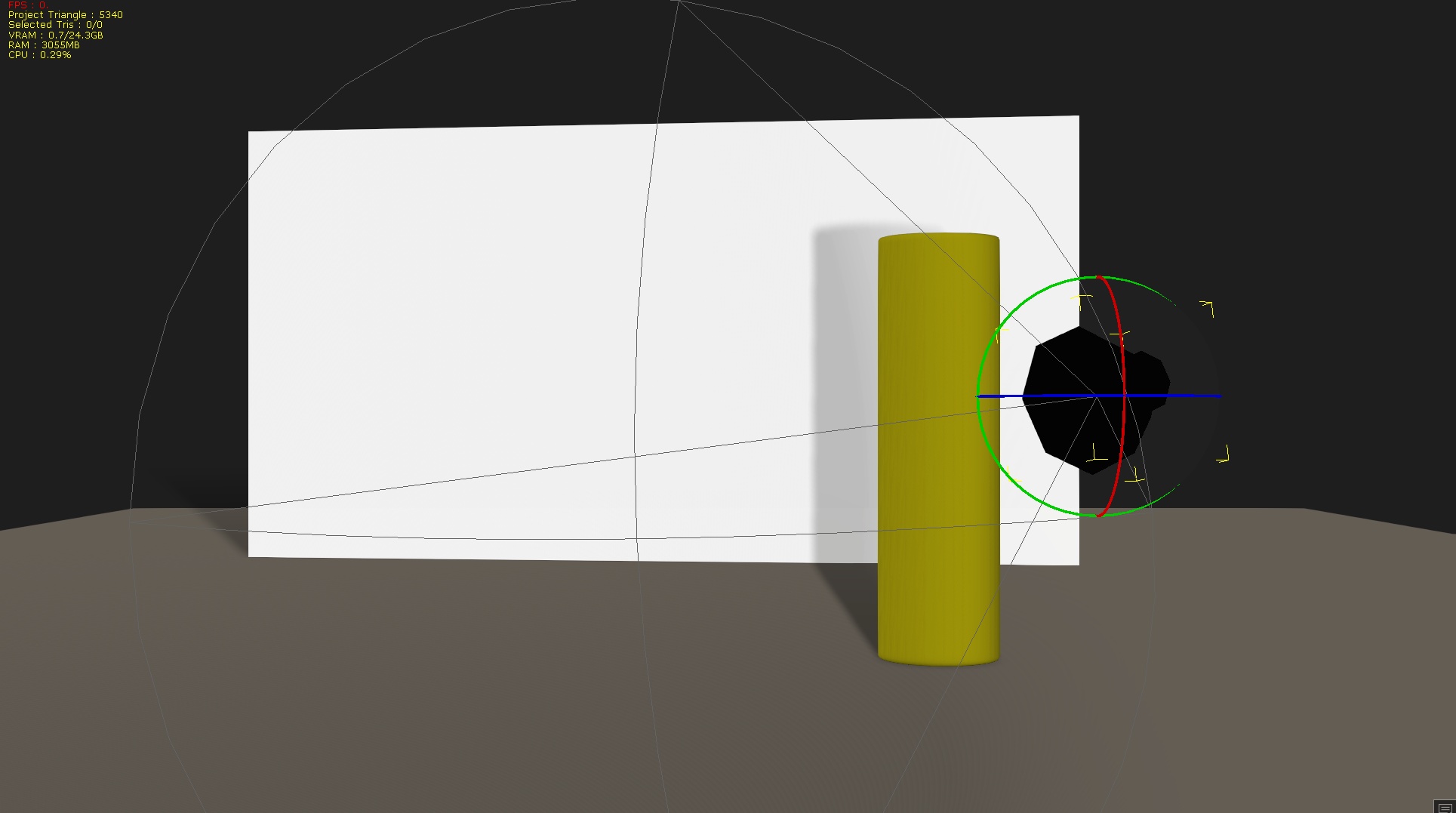

Your suggestion 2: Shadow (with shadow caster) on a white screen (screenshot #3); "...render just the shadow on a white screen of the same proportions as your video and place the resulting video in the Blend channel, set to Multiply. The black will suppress the image from your video." I do not understand what to do: How can I render just the shadow?

I see. Of course, the video projection would be on the object blocking the screen. I didn't think of that and would not know how to do that...:unsure:
