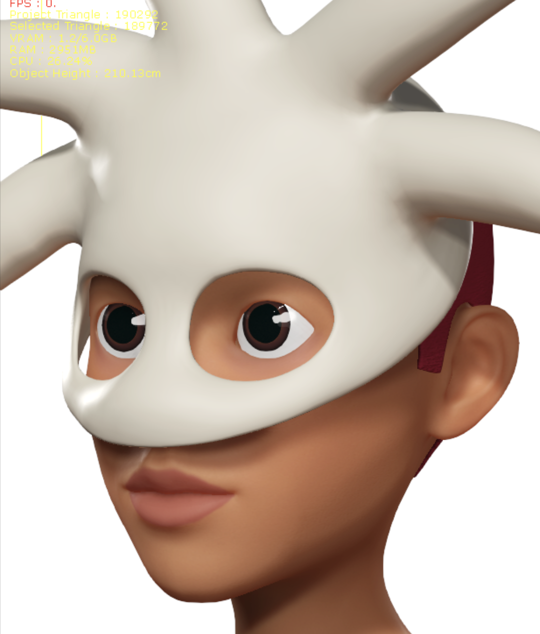

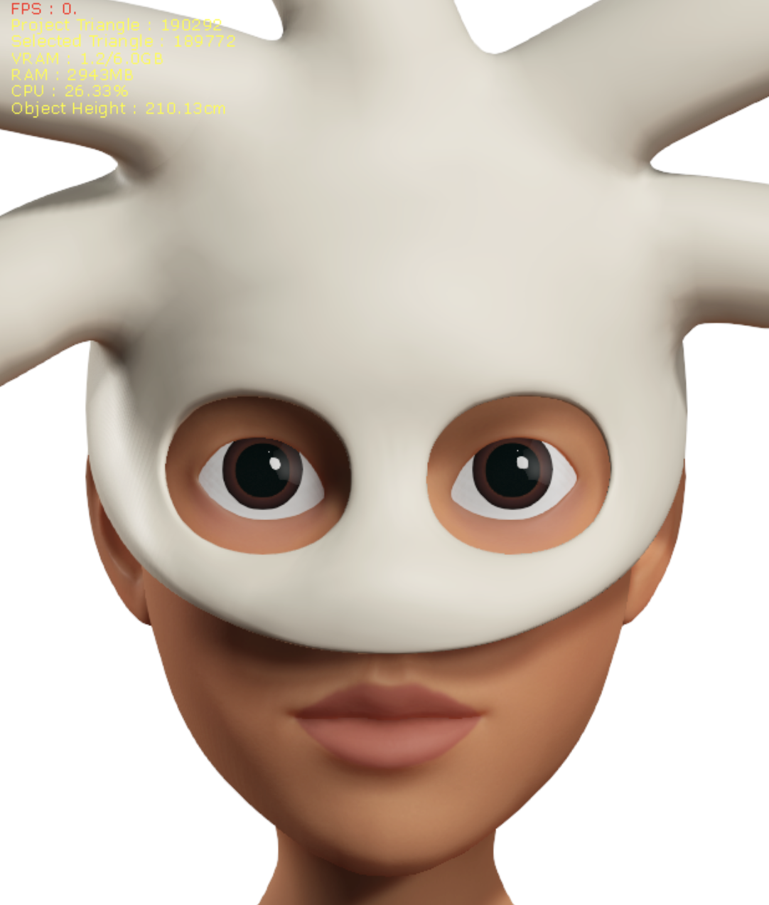

For over two weeks now I'm unsuccessfully trying to find a way to create stylized Eyelashes for my character. I tried so many different ways to solve this but it's just not working. I would be so thankful for every idea, suggestion or help!
The eyes of my character are big and almond-shaped and I want to have a super simple black line on top of the upper eye. That's the things I tried so far:
1. Deforming the CC4 eyelashes in Zbrush: The shape is too complex and when the character is blinking they don't move correctly and not stay in the right place
2. I painted a black line on the texture which looks okay but looks weird while blinking since the lid mesh is stretched to close the eye
3. I tried to sculpt eyelashes on top of the body mesh in Zbrush but that didn't looked good. I found an IMM eyelash brush which looked good but the problem is that the polycount didn't stay the same so that means I can't update the character in CC, right?
4. I sculpted eyelashes in Zbrush and imported them in CC4 as skinned eyebrows. Kind of worked but they aren't staying in the same place and don't follow the blink.
As you can guess I'm having a super hard time with that and would be super thankful for any help!
