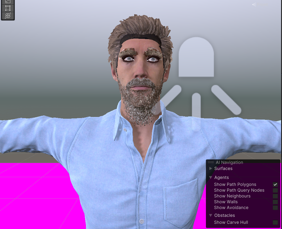

Thanks again Victor - those fixes worked.
For benefit of others - I did not delete the sample scene files which meant the correct diffusion profiles were available to be automatically assigned when importing - this fixed the green character issue. To fix the eyes I created a new volume within the scene, then added an override for screen space refraction (you add overides from within the volume inspector).
