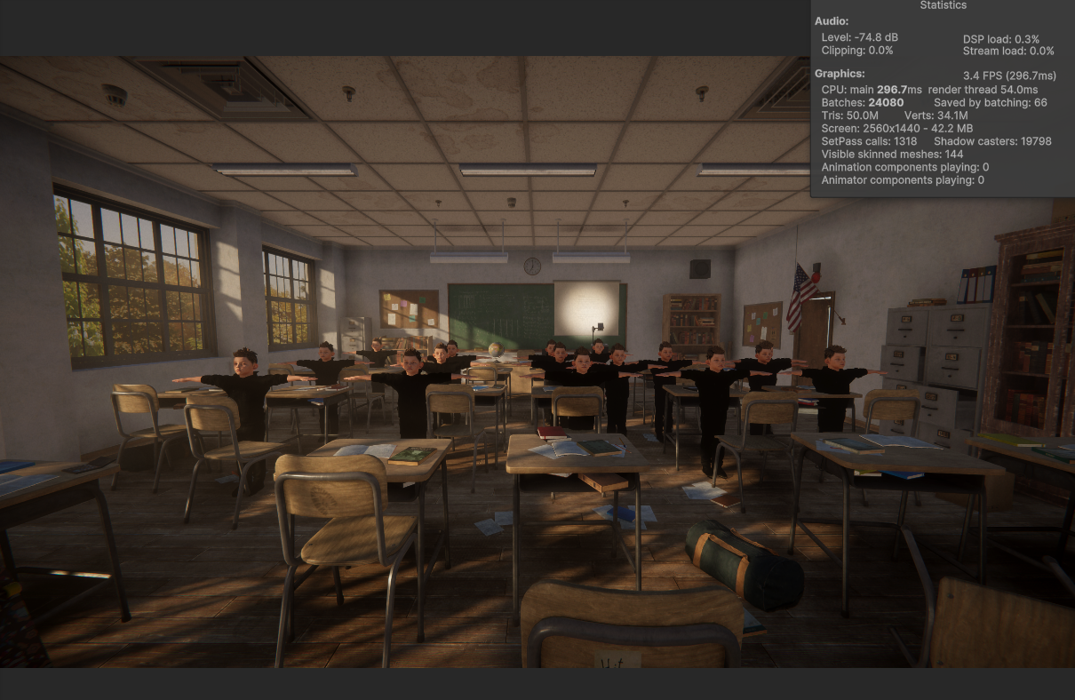

Forum Post I see that with the 3D pipeline, you recommend also using the post... By thubbard ( 4 Years Ago )
Forum Post Any screen space effect (e.g. post processing) is heavy in VR, and... By jerome.dipietro ( 4 Years Ago )
