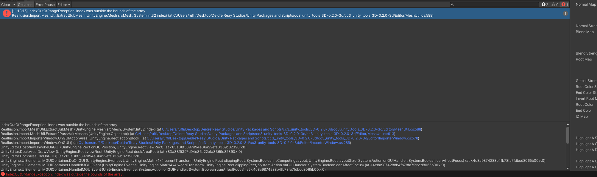

Maybe something like that. Been testing all morning with some good results just messing around, but i have received a few errors from unity on the 2Pass button press.
Error MEssage.PNG (73 views, 108.00 KB)
It's crashing if there are no vertex colors in the hair meshes. That's fairly serious so I'll fix it straight away with a couple of other fixes I've noticed:
