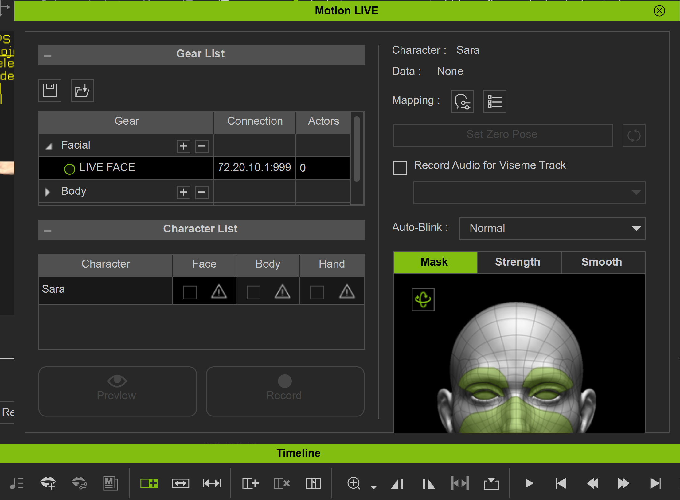

Hi...
Try going to Window > Workspace on the Menu Bar and select Standard so it is checked like below.
Now click "Reset Layout" to reset the layout to the default layout when iClone was first installed.
Finally try opening the Motion Live plug-in from Plugins > Motion Live > Motion Live on the Menu Bar and see if it is displaying correctly now.
If you still have problems, please let us know the screen resolution you are using. Thanks.

Hello,
I just installed motion live plug-in but I can maximize, scroll down or extend the motion live plug-in window. I wonder what is the issue and how can I fix it.
