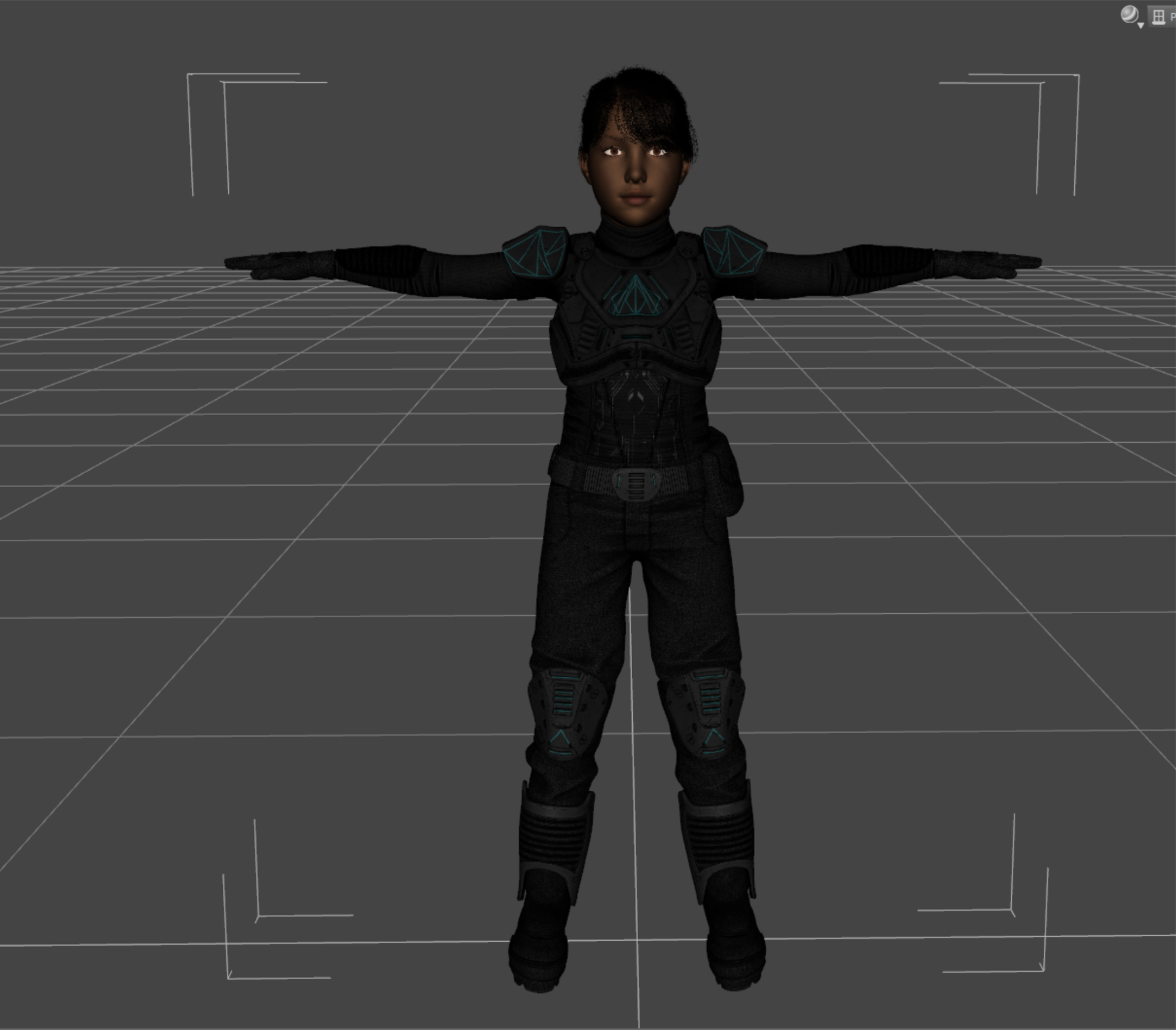

Hello all,
In need of some assistance with bringing Daz3d materials into Character Creator 3.
I have followed the information here:
https://manual.reallusion.com/Character_Creator_3/ENU/3/Content/Character_Creator_3/3/09_Transformer/Advanced_Conversion.htm
Kellytoons tutorial here.(Awesome channel!)
https://www.youtube.com/watch?v=m1kn5DlXabQ
And the Reallusion video regarding the same thing.  However, with that being said, it is not working for me.
I am using:
Daz Studio 4.12 (latest)
CC3 (Latest)
Genesis 8 Female
Sci-Fi Battlesuit
http://www.daz3d.com/sci-fi-battle-outfit-for-genesis-8-females
Below are my settings and their results.
This is what I see in Daz3d
https://forum.reallusion.com/uploads/images/4dbdb416-782b-457d-8207-059f.png
These are my export settings from Daz3d
https://forum.reallusion.com/uploads/images/667381a8-ca7c-4ba0-a421-1bff.png
These are my transformer import settings.
https://forum.reallusion.com/uploads/images/1f5fa63b-75e7-493e-a27f-422d.pngThis is what appears in CC3 after import.
https://forum.reallusion.com/uploads/images/58e7814d-6ffe-4d9f-845d-0bdd.png
Any ideas or thoughts on what I am missing?
Thanks in advance,
Walter

The armour actually didn't come across fine -- look and you'll see there are no glossy materials, for example (and yet there are in the armour).
However, to get ANY character textures after you choose "Advanced" (which you must ALWAYS choose no matter what you are importing) you must checkmark Bake Body Texture and then choose your resolution.
If you don't, the default CC3 body textures are assigned.  So -- rule of thumb is this: for clothing/hair only, do not checkmark this (it will slow things down TREMENDOUSLY particularly if you choose 4K).  But if you want the avatar's skin to come over, you MUST checkmark this.

I didn't focus on the armor as what got my eye was the skin shading and so the armor became secondary.  As you can see in my settings in my original post, is I did check bake textures and they did not come across.  I am not too concerned with speed due to the specs of my system.  If I have to wait longer for something to look the way I want, I can deal with that, but thank you for the heads up on the hair.  Do I need to change any of the settings with the material when I click bake?  I see options for default, use original, etc next to each individual item that it is bringing in.

That was what I did and I have the issue.  I used the standard gen 8 female that comes with Daz3d.  I morphed it using the Growing Up Bundle here https://www.daz3d.com/growing-up-bundle-for-genesis-8-female-s-and-male-s to maker her a child and then used a skin from Toon Generations 4 from here.  https://www.daz3d.com/toon-generations-4-mega-bundle-for-genesis-8.  I made sure to use all items that were for Gen 8.

I chose the TG Skingtone - Medium Brown

Okay, I looked deeper into this.
Toon "skin" isn't a texture -- it's just a base color.  So that won't come over, no matter what you do.  IOW, there are no maps whatsoever with the Toon Generations stuff, just a skin color setting (which you can do yourself -- just select all the skin surfaces and use the Adjust Color tab to adjust them to whatever color you'd like).
So -- no real error there, just a misunderstanding on your part.
