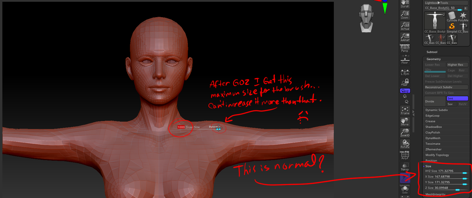

Hello, this is my first time using GOZ with Character Creator 3 and I'm having this issue. Is this normal? The brush size seems to be too small and can't increase it any more than that.
Also, is that size normal?
I downloaded the CC3 templates for 3DMax and Maya (I'm using Blender) but the FBX I'm importing to  Blender seems to be the correct one. I guess this is a bug between the GOZ Bridge.
I'm the only one having this problem?
Also, do you guys have an official Discord channel? This is essential O.O !
Thx
https://forum.reallusion.com/uploads/images/f84d1d35-7c2f-489e-902d-acfe.png
