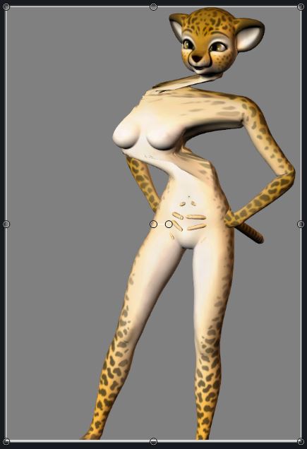

I am having this problem as well.
This is Melody for Aiko 3.  I don't know of a way to get her into CC3 since she is older than V4/M4, so I am using 3DX.
I have had this problem with a couple of other figures.
I have tried changing the bones around, but nothing seems to be working for Melody.
If I use the DAZ Preset, I get the green ball in the upper left, but the convert button won't light up.
If I try moving the bones around I get a red ball in the upper left, and the convert button won't light up.

Maybe the OP means the breasts?

Unfortunately, I'm not really understanding the problem. If you have converted the Daz character to a non-standard character then you should be able to take it into iClone 7 and animate it in the normal way. For example, open Edit Motion Layer, select the Chest and rotate it as required. Are you not able to do this?

After importing Daz character into 3dxchange, the character chest will not move. All other body parts articulate/stretch, however the chest is fixed in place during animation.
