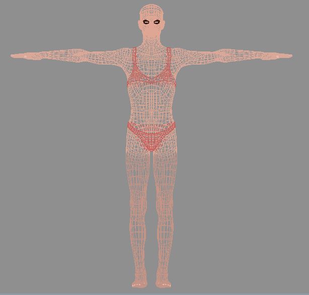

Hi, thanks for getting back to me however neither of the suggested solutions had any effect and exporting to fbx after following these instructions still resulted in the classic "T" pose.

Apologies for the confusion. The second solution I gave "Set As Default" only applies to export as .iAvatar. As you are exporting FBX this won't apply. :Whistling:
However the first solution to include the pose in the export panel should work fine. Do remember that the custom pose is exported as an animation clip so you will need to load the clip to your avatar once opened in your target tool. Depending on the 3D software you using, your avatar may open in a t-pose but you can then apply the custom pose that is included in the FBX.

I'm importing the .fbx into a 3D CAD program and, even though it's fairly top end, I don't think it can read the animation data.  I'll look in more depth later.
