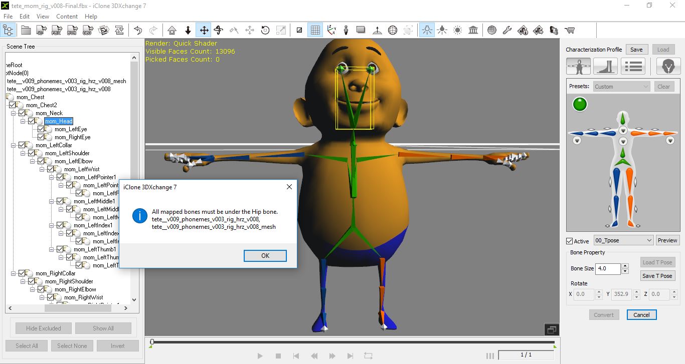

Hi Team,
I am trying to convert my FBX character to Non Standard character but this error popup when clicking Active button,
Attached is the FBX file if any one can assist to convert,
Best Regards,
Issa.

Hi Team,
I have already updated the software,
But still i have this error, see attached image.

Now THAT error sounds like you mapped the bones improperly.  How are you selecting them?  Be very careful how you do this (if you can make a video showing your selection process that would help, but in general the two bones, the hip and the spine, need to be selected right.  I don't have the time right now to download your project and try again, but if you can't figure it out and no one else can help I'll see if I can give it a go this afternoon).

The basic problem is with your rig -- it's pretty bad (the spine and hip in particular are wonky).  You can still get it into iClone, but the motions won't work very well (just select not the long bone but the kind of y-shaped bone that's directly above the hip bone).
What you really need do is re-rig this character (you can do this in Mixamo).

I am able to characterize the skeleton just fine, after finding the correct bone to use for the hip.
The problem is the mesh is not correctly weighted to the leg bones. The entire leg is weighted to the lower-leg bone, so the knee cannot bend with the skeleton properly.
