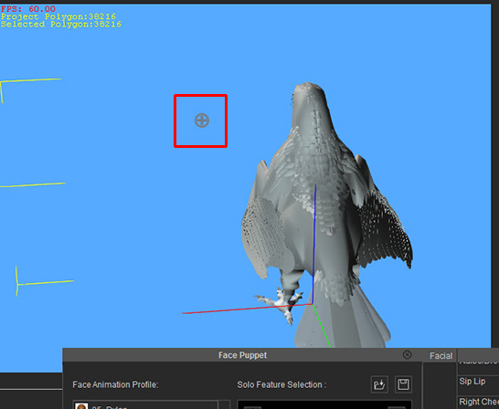

Another question, this seems annoying to me, but perhaps it is a "feature" and not a "Bug"
I have 2 scrren shots attached, crosshair1b and crosshair2b.
I have discovered that depending on the distance away from my object that I hit the spacebar (to begin the Face Puppet preview), I get a different amount of morphing.
As you can see, in "crosshair1b" when I hit the spacebar the cursor (red box encompasing cursor) was some distance away from the model, and when I move the mouse to the extreme (for this morph) I get an incomplete wing closing.
in image "crosshair2b" the cursor was on the tail of the model (red box encompasing cursor) and that gives me an almost complete wing close.
This makes for a very imprecise control of a morph.
Is this supposed to work this way?
There truely must be a better way of handling non-standard morph types....

You, Sir, are a genius!
That seems to be the issue, for the Jaw (where I assigned the morph), the weight number was 0, I set it to 50 and it looks about right.
I guess I now change the weights and then hit the "Save" button to save my weights for that model?
Hopefully, I can move forward from here

Maybe iClone defaults to %80. The facial puppet panel has some strength percentage setting options.
That little icon circled in green is the settings. It'll open a pop-out side panel.

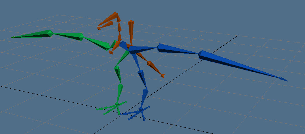

I have tried the above set up based on the 2 vids ‘Tutor’ provided links to. and there are two issues I need to overcome.
1) I have a bird model, the "characterization" bends the knees in the wrong direction for a bird (right for a humanoid)
So, can this be overcome?
2) The morph targets: I have morphs that are in no way related to the finite set that iClone allows you to set up.
I have wing folding and tail opening and feather spreading... etc Is there no way to add in and name your own custom Morph targets?
3) Finally, if I cannot solve issue #1 (for a bird Model) I can at least bring it in with the bones active (but no IK)...
If I do this, then How can I also import a list of Morph targets for a user to apply?

You have plenty of bones already in the proper hierarchy. Remember you only need the 15 that make up the basic humanoid.
Assign the root bone of your skeleton as the hips. It is alright to skip over bones in a chain as well. This effectively makes the skipped bone an extension of the previous bone. Makehuman skeleton has extra bones in the arm, so I do that a lot.
make the last bone of the arm that has mesh weighted to it your "hand". Don't bother with fingers for this.
Only bother with the toes if they match "Human" toes. In the human iClone avatars, all the toes are weighted to a single bone (It's the little gray diamond in front of the foot in the characterization panel).
Extra bones can be assigned as "extra" and can be animated, or they can be assigned as spring so that they will bounce with the avatar's motion. Note that springs "spring", but are not affected by gravity. The spring is often used to make the female avatar's breasts bounce.
