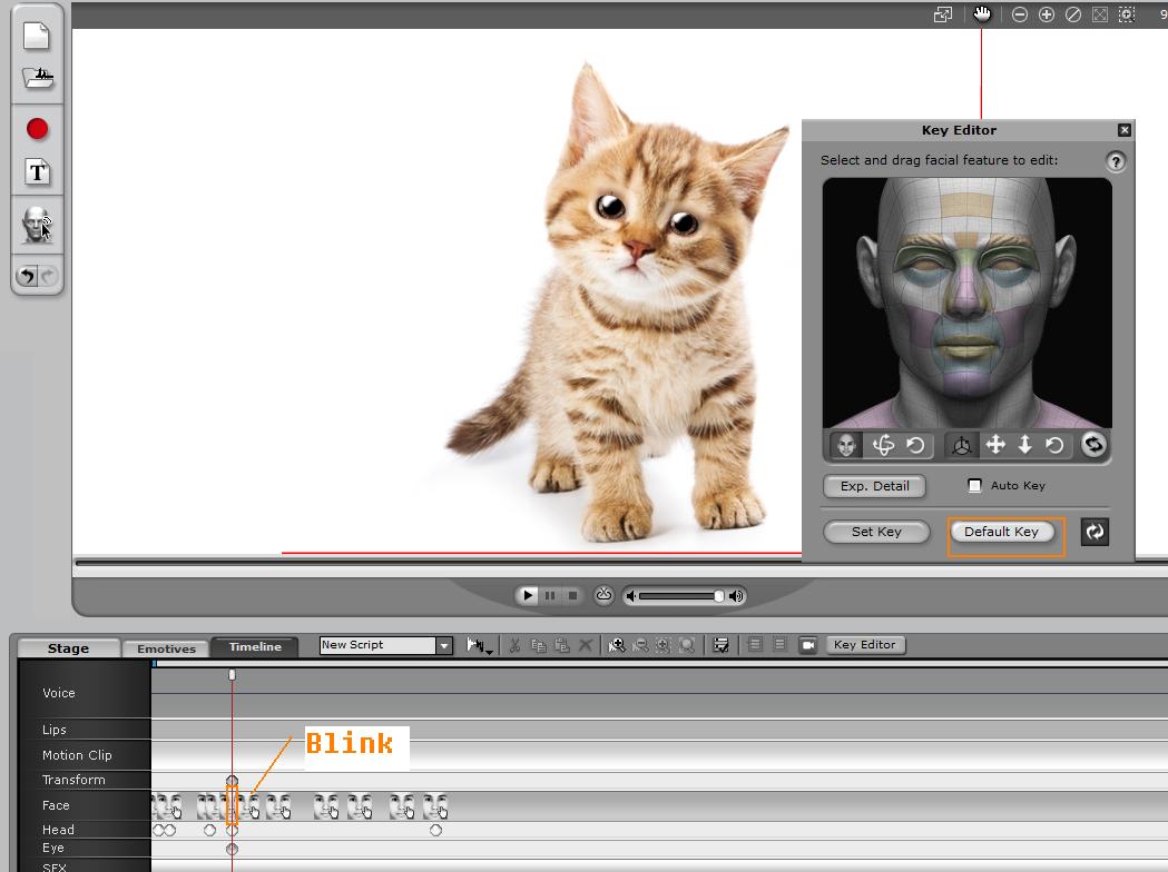

Please try to do the following instructions in order to help you to solve your issue.
1) After the keys have been collected automatically into your timeline, please right click the MotionClip group, and then choose “Ungroup”.
2) Click anywhere before blink key on the Face track.
3) Click on “Key Editor” button to call out Key Editor.
4) Click on “Default Key” button in Key Editor.
5) Playback
Note. Please click the attachment and see this image.
We are wondering whether the speed of eye blinking improves. If the problem persists, we would be grateful if you could provide your project file to us. You can contact us via Support Form, and then you are able to attach your project file to us.
