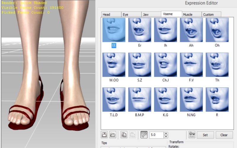

Well I've solved the 'Talking Feet' issue finally! :D
I had thought I fixed everything involving the feet in DAZ, but when I brought her into 3DX and then apply to iClone after the normal routine, she still sank into the floor and the feet still moved with every visemine! :crazy:
It was only after I sent her back to 3DX to check the visemines did I find the problem. I have always zoomed into the face when in the Expression editor, as I'm sure everyone does, but this time I was just doing a quick check and had the whole body in view... When I clicked on the EE visemine setting... the feet moved down! When I cleared the visemine the feet moved back to where they belonged! What the...? (See attachments)
And again when I clicked on the Eye Brow settings, the Jaw settings, the feet moved down again and when cleared they moved back!
This told me that there must be a foot morph that got sent over with the figure and low and behold there it was, in the Expressions list! (Sorry I didn't get a screenshot of that)
All I had to do was set that morph to 0 and all worked fine from there on in! The foot morph was one of many 'High Heel' morphs I had tried in vain to set the feet in the heels correctly. I had forgot to undo it and then locked the morph by mistake so it was added to the morph list when exporting to fbx.
No more sinking into the floor, no more talking feet! :w00t:
