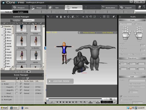

Thanks for the tip Cricky, I rechecked those settings,and don't see anything odd. I'll post a screen capture of those settings next time.
Vit, I used the "Autodesk FBX" setting.
Update:
I finally solved my problem, I had inadvertently overwritten a few folders which affected the FBX export plugin! I just deleted the bad folders and reinstalled DAZ 4 and presto!
Everything is working normal again.:)
