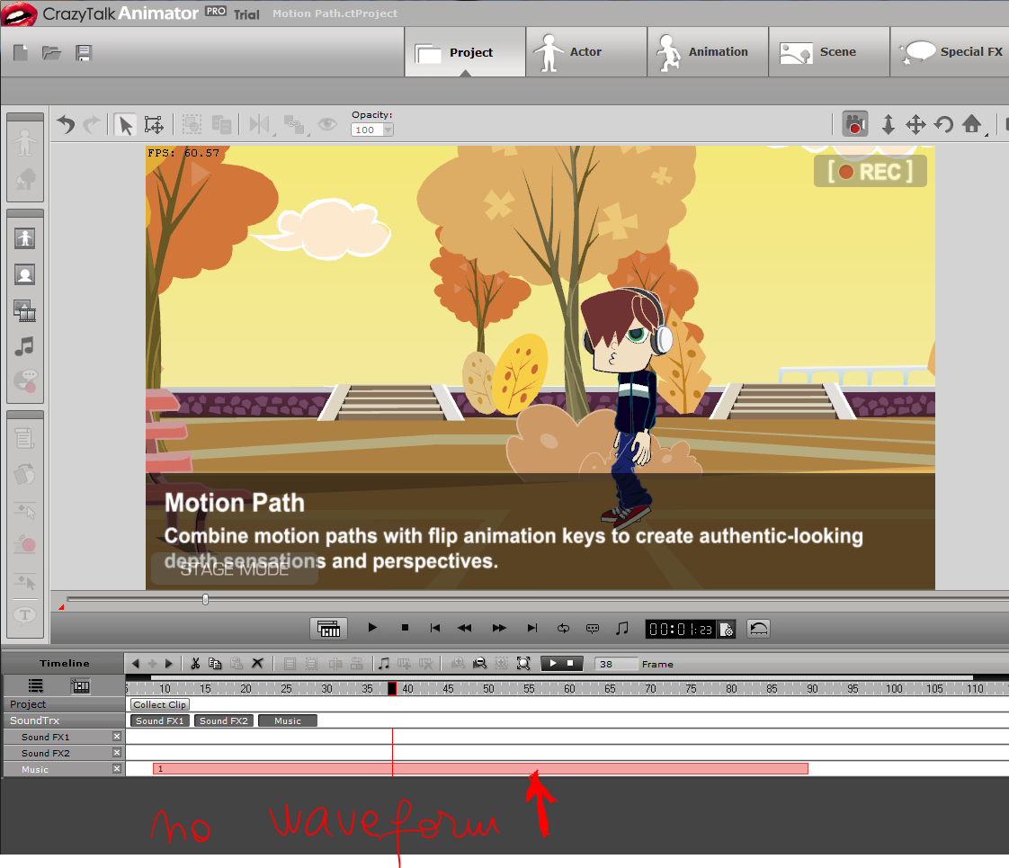

it's not necessary to write about how IMPORTANT is the ability to see the waveform in a character compositing sotfware.
i see that waveform in audiofiles can be seen in CrazyTalk , as in here: http://youtu.be/-E_SDrE2IUc?t=2m52s or in capture.png
why it doesn't exist in Crazy Talk Animator??? as you can see in Attachments: nowaveform-in-CTAnimator.PNG
i was about to buy it, but without this feature i cannot use it for animating lips for character and so on.
or do we have waveform, but i don't know how to view them ?

Yes, you can see the voice waveform.
With an imported wave file or recorded voice using CTA loaded for an actor, go to the actor in the timeline and click on the facial button for that actor. You will now see the voice clip and facial clip tracks for the actor. Select the voice clip that was inserted and right click and then ungroup. Expand the voice clip to show the voice and lips tracks. On the voice track click the button to the left of the header "Voice" (looks like a waveform) and the track will be displayed as a waveform.
Note: The waveform display is only available in the voice track, not the music or sound FX tracks.
