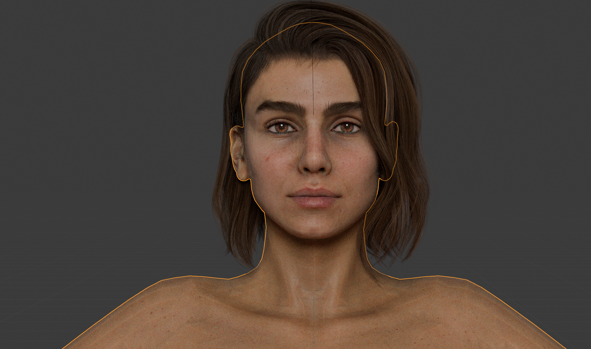

I have the same issue. When I use Blender 4.2 or older I get this issue. It only occurs on the skin shader, everything else is just fine. When I use 4.3 I get a skin shader error, but the issue does not occur. I've also switched to CPU rendering, but no luck there.
I've also added a screenshot, Don,t pay attention to the orange outline or black line on top. Look at the throat area or the nose.
All other props or clothes are not affected
