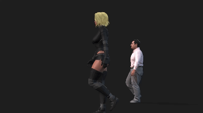

Hi! I’ve been using a walk animation cycle from the City Life pack and have looped it over a range of frames. The issue I’m running into is a glitch when transitioning from one loop cycle to the next, where it seems like the character is slightly misaligned between loops and jerks back then forward. Can anyone advise me on how to smooth this out?
I have also used it as a motion clip and use the motion correction, but to no avail.

If you zoom all the way in at the beginning and end of the clip and scrub,
you'd notice that the first and last frames are static causing character to "freeze" at loop connection.
It's an omission on the developers part.
Solution is simple. Delete first and last frames by breaking the clip at the beginning and end.
Save the clip as custom to reuse in other projects.

Thank you so much. Such a simple solution for what was giving me a mighty headache.
