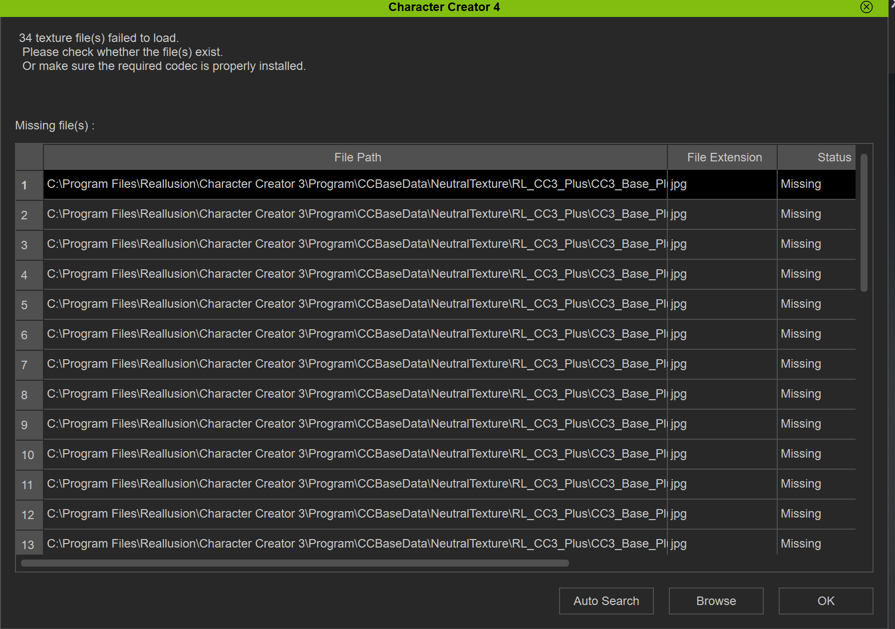

I have a problem while importing an adult of Godegisel body. There is a list of missing files as shown in the attachments.
I successfully imported other actors (age 5, age 9...) without any problems.
All female actors were imported without any problems too.

Have you checked  in the folder location shown to see if the texture files are actually there? If they are not then you might need to uninstall CC3 and reinstall again from the Hub.

What I see from the missing files list, the problem comes from the fact that the folder is "character creator 3", not "character creator 4".
When I browse the correct path and proceed to autosearch, I can import that male actor (adult and age 5) with skin.
If not, I will get a white male actor.
I tried to search in the Regedit for "character creator 3" and found nothing.
Why after correctly meeting the good information by autosearch, the information is not updated?
