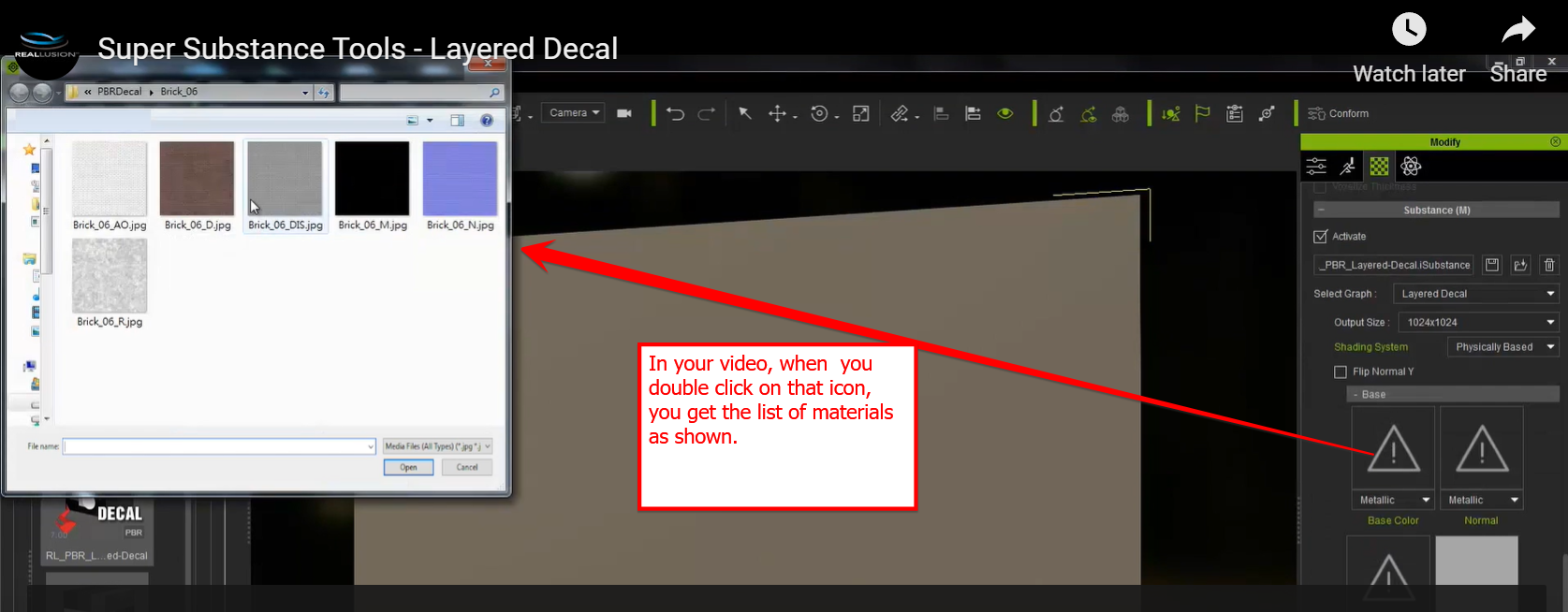

Thanks, 4u2ges, for helping out.

It's not really my video, it's one I found, sorry. I haven't really used the feature myself and I hoped the video would help but it doesn't seem to be that simple.
Looking again at it, it seems they use resources in a PBRDecal folder that I don't have myself.
But what you are looking at in the images you posted are thumbnails of Substance Materials. If you look into that folder you will see pairs of files with the same names but different extensions. Those you don't want to use.
What you need to find instead is a regular jpg or png of, for example, a brick texture. But then you also a normal map, etc.
So this is not particularly straightforward to use. I could probably figure it out, but I don't have the time right now.

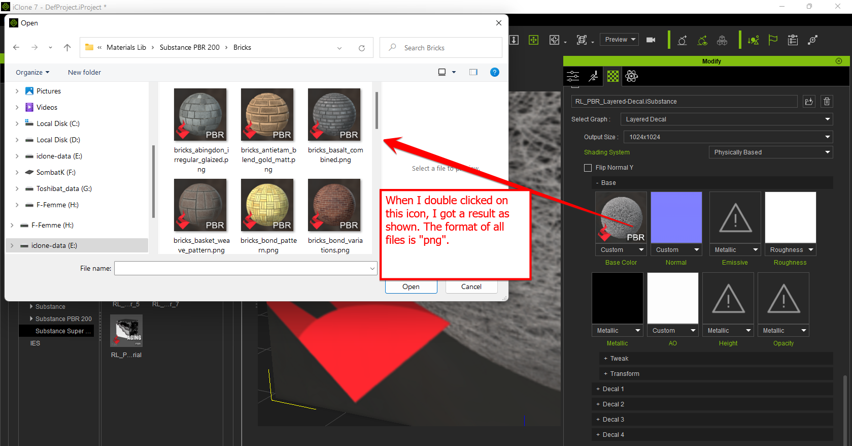

Thanks for your reply.
I watched your video several times but I can not understand what is the problem.
In the first picture (captured from your video), I see that the list of materials is totally from mine in the second picture.
The problem is that when I double clicked on the first icon of Base options, I always got the thumbnails of png files. (I cannot see "brick_o6.png"...
Please help...

I think the problem is that you use a thumbnail for your texture. You will need an image file (jpg or png) of a wall.
It's kind of fast, but this short video explains it:
https://forum.reallusion.com/uploads/images/436b0ffd-1242-44d6-a876-d631.jpg

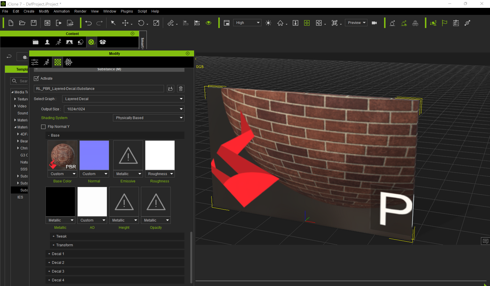

Hi there!
I have a problem with substance super tool in Iclone 7 and Iclone 8.
Each time applied the decal from the substance super tool, I got a result like shown in the attached picture.
I tried to work in Iclone 8 and encountered the same issue.
Please advice...
Sombat
