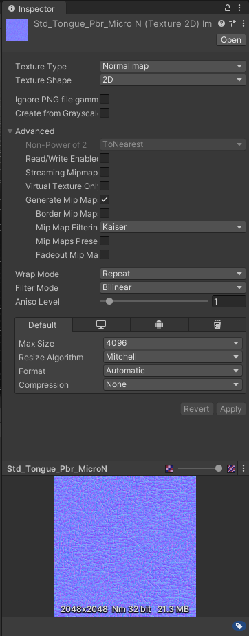

1) Don't delete _Extracted meshes when reimporting
The tool currently deletes and recreates new game objects for _Extracted meshes, like hair. This means that anything having a reference to one of the _Extracted objects will lose the reference if the character is reimported. Ideally the tool wouldn't delete/recreate these game objects, and instead update the existing one if one is already there. Currently, any time I reimport a character, I need to go clean up various broken references. And any components/child objects added to the _Extracted game objects will also be lost.
2) Avoid/consolidate redundant textures
This is probably significantly more challenging, but maybe you have a suggestion as to how I might work around this. I've noticed that there are many textures that are essentially shared/identical between different characters. For example, MicroN maps, teeth maps, etc, seem to be identical between characters. This results in significantly higher memory usage, since each of these characters essentially has a copy of the same textures, rather than all using the same actual texture. Ideally there would be a way to detect this, and to instead assign a "common" texture to the materials, rather than each material referencing its own distinct duplicate copy of each texture.
Hopefully that make sense. Here's a screenshot of a tool that identifies duplicate files in my project, and it finds a lot of redundant/duplicate textures that would ideally be unified to only a single copy of each texture.
https://forum.reallusion.com/uploads/images/48f82f2d-13a0-440e-b06c-dae0.png
Thanks.
