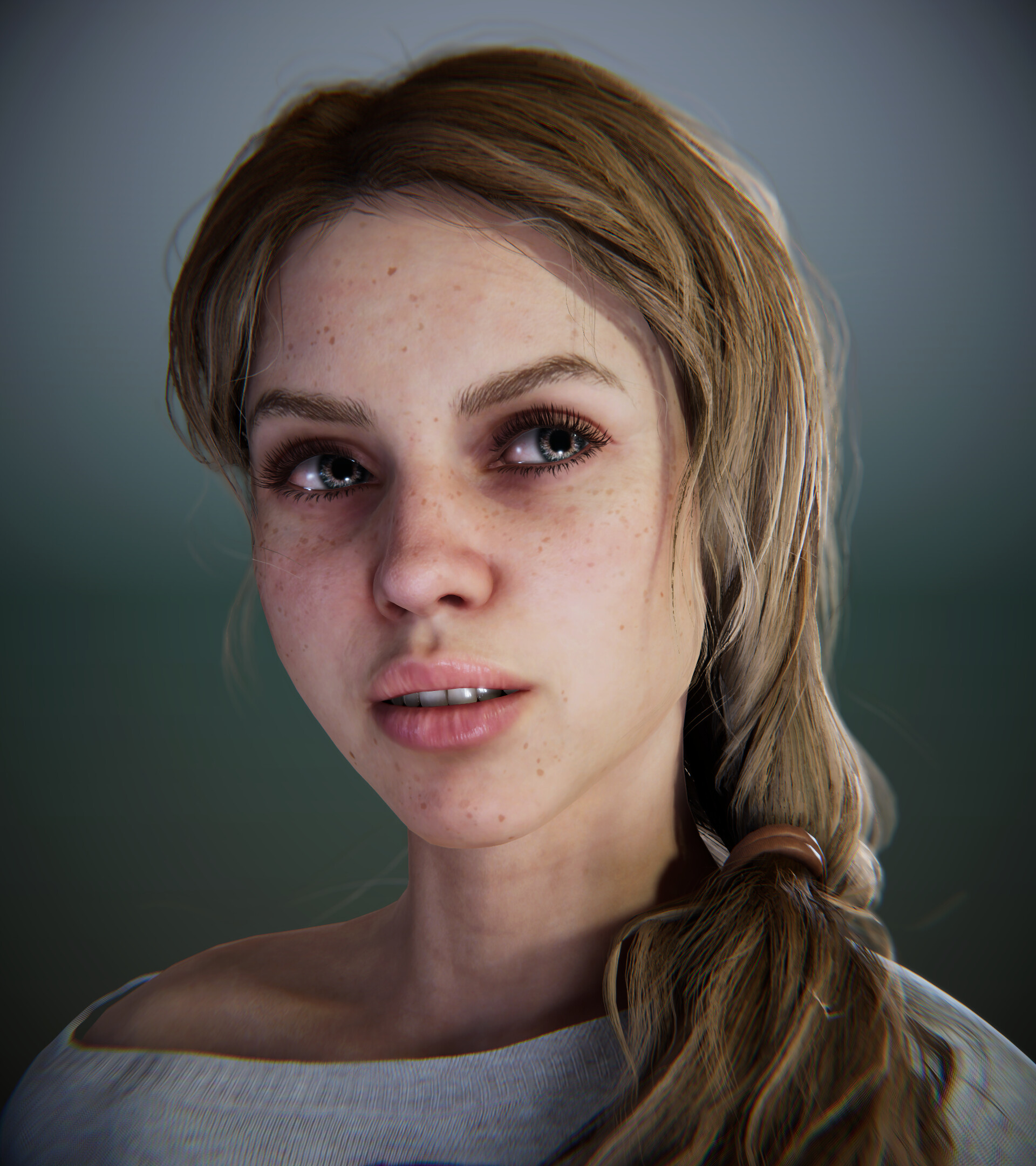

Unity Auto-setup Release 1.3.8
Built-in (Unity 3D): https://github.com/soupday/cc_unity_tools_3D/releases
URP: https://github.com/soupday/cc_unity_tools_URP/releases
HDRP: https://github.com/soupday/cc_unity_tools_HDRP/releases
Documentation
: https://soupday.github.io/cc_unity_tools/
Full install instructions here: https://soupday.github.io/cc_unity_tools/installation.html#
Changelog:
1.3.8
  • Added tessellation shaders and templates to 3D and URP pipelines.
  • Upgraded to Amplify 1.9 shaders in 3D and URP pipelines.
  • Fixed some issues with hair shaders in 3D and URP.
  • Updated Hair shaders and eye shaders.
  • Added Hair Bake preview button.
  • Updated preview scene lighting presets, should all look roughly the same lighting across all three pipelines.
https://cdnb.artstation.com/p/assets/images/images/054/439/047/large/victor-soupday-screenshot-220930-125329.jpg?1664538893
Unity 2022.1 HDRP Render: SSGI, Ray Traced Shadows
