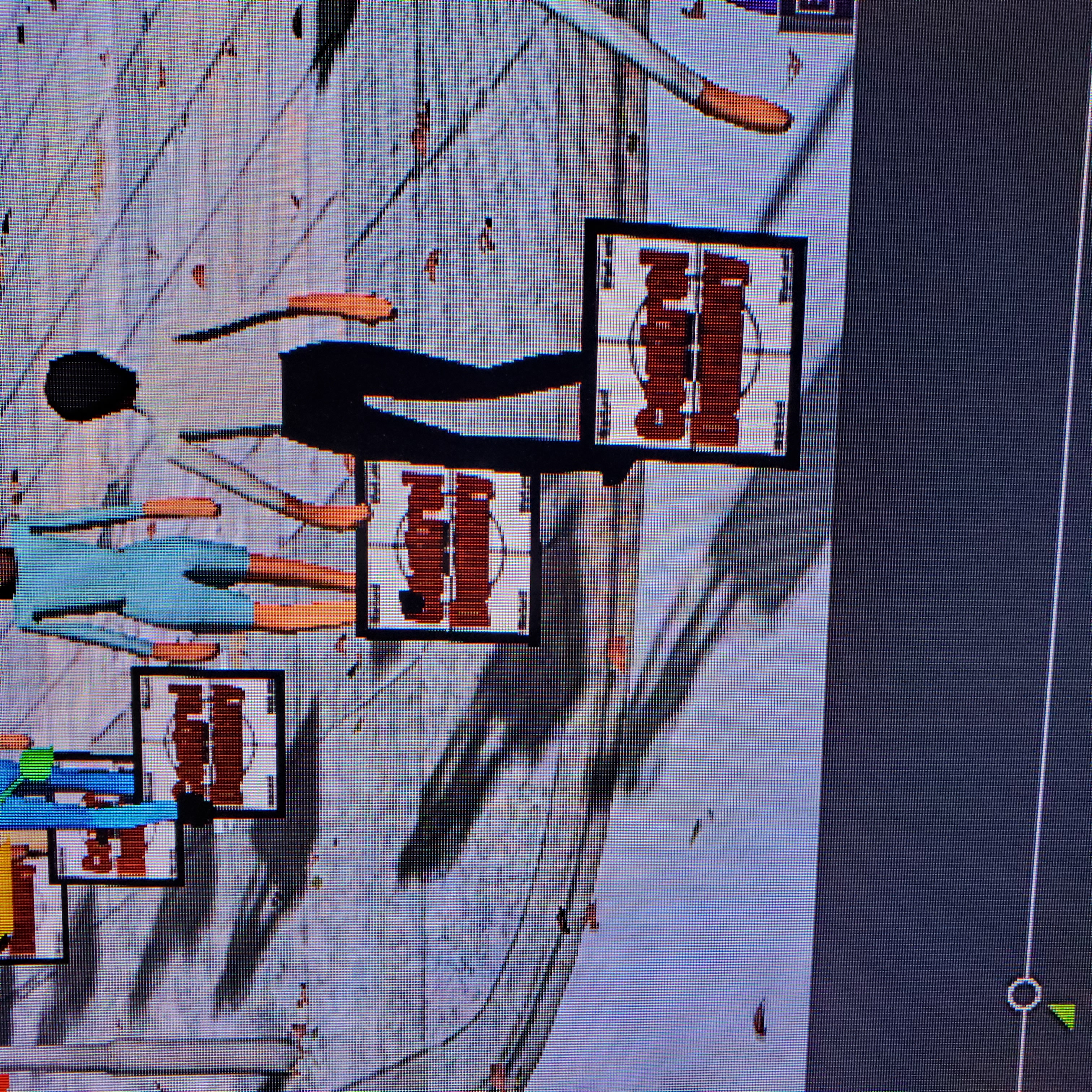

Hi, I bought Sidewalk crowd single file.  It didn't work as the youtube video showed it would, but I'm okay with that.  the problem is that there are these signs at the bottom of each of the characters, they say control dummy on them.  I can't figure out how to remove them.  There is nothing to click on, but If I move a character, the sign will separate from the character, but not disappear.  Will somebody please help me to figure this out?

I just checked with a similar pack from Warlord that  I have (which I have used in the past as it is from iClone 5) and something has changed, making the controllers visible.
The larger controllers for a group of pedestrians are dummies, but the smaller ones for the individual pedestrians are not. The only way to make them invisible is by setting the Opacity of their Diffuse channel (texture) to "0".
As this is rather involved, it would be best to contact the developer Warlord as this should be fixed. I don't have the particular pack, so explaining it for the pack I have would probably not help you.

Okay thx, Animagic.  I just did the zero opacity trick.  It worked.

You can also just select them one-by-one, and un-check and then re-check the "Dummy" box. It just needs to be reset on older props. Then save the prop as a new crowd prop.
