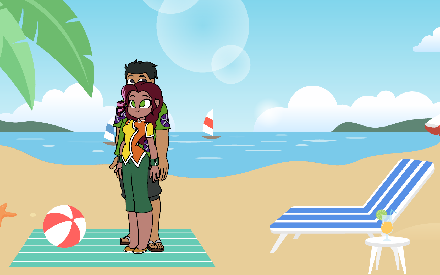

In order to fix your character I followed this procedure. Downloaded your files Imported the pngs into Photoshop via Scripts > Load Files Into Stack Opened a PSD template file for G3 Elastic Folks male Copied your parts into the Template file and put them in the correct corresponding folders Cut up some of your parts that needed to be in separate layers (like the head) Added rounded circles with same colors to the ends of body parts so the joints overlapped Added some face parts from other characters Aligned the bone indicators to the correct places Imported the PSD file back into CA4 Took about 20 minutes while I watched the baseball playoffs. It was a personal test to see how fast I could do it. Needs a lot more work but you get the idea.
