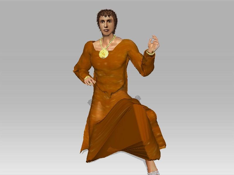

richachd (12/19/2007)
Hi
Now my next problem is a texture problem When I expand the legs of my character its cloth texture doesnt remain proper .
You can see it in attached jpg file. pls also give solution of this problem.
Thanks
--Meenakshi
Hi Meenakshi,
From the screenshot it looks like you still need to do a little work on adjusting the envelopes and setting the weights as it looks like the right and left leg envelopes are having too much influence on the opposite legs causing the weird stretching.
It is very much a case of trial and error in these situations till you get it just right. Try reducing the size of the leg envelopes to lower the amount of influence they have over the opposite sides of the gown and see if you get improvements in the stretching.
Pete

Hi
Thanks
--Meenakshi
