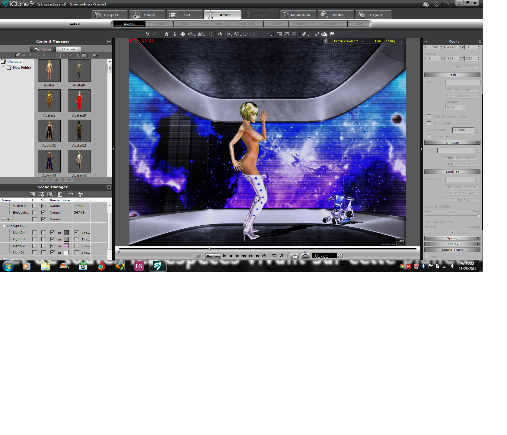

1) 64Bit Shortcut Desktop Icon has; (64 Bit) included.
See Screenshot:
2) 64 Bit WMV (VC-1) Export File Format is High Definition. Most people have HD Widescreen Monitors these days. So, select an HD Resolution in the Drop-down. 720p is the most common for Upload to Youtube & Vimeo.
3) Setting your Export File to 720 Resolution will automatically set iClone Viewport to the same Resolution. Setting your Monitor Resolution to the same Resolution, makes for easier Editing.
iClone's Edit Realtime Render Engine, dictates that what you see in Edit Playback, is what you see in the Final Export to File.
Screenshot:
