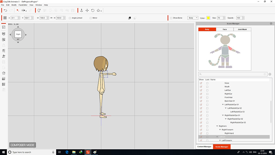

Hey so i'm new to crazy talk animator 3 and i'm trying to make a custom G2 character. For some reason in the sprite editor I cant replace the sprites for different angles. First i put the template G2 dummy character in stage and then switch to composer mode.I then click on left forearm and sprite editor button to change it success.
https://forum.reallusion.com/uploads/images/21753add-fd13-4b58-a10c-86b0.jpg
 When i open the it in stage mode 270  it is not visible to me.in  other angles also it get same problem -

then i open the composer mode it visible..when i mirror it at right side
https://forum.reallusion.com/uploads/images/033ebe04-dbd1-4b1f-a0e0-ee40.jpg

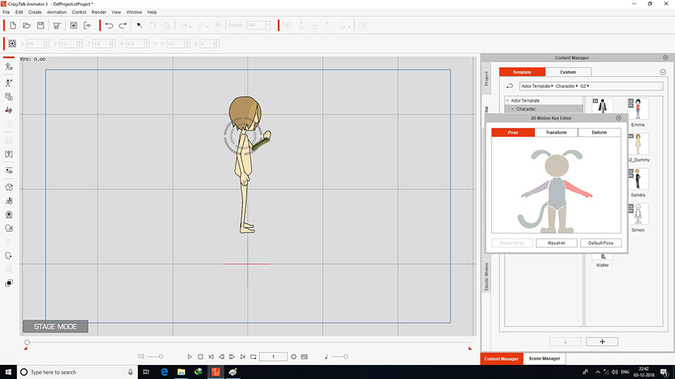

again in stage mode
https://forum.reallusion.com/uploads/images/3a52dbdd-a371-40ae-b043-3e11.jpg
and test it in stage mode with 2d motion key editor the sprits of other side is not visible

By gvraju.666 - 8 Years Ago
hello sir
thank for replay ..sir we r using only vectors sir ..we or attaching the  vectors to u pls give us a reliable answer ...
we r not getting how to rig in 270 angle sir
By jlittle - 8 Years Ago
Ok, here is the issue: To use the Mirror function in Composer Mode you MUST have ALL the sprites for ALL angles loaded before executing the Mirror Function.
If you load a sprite for each angle for a body part then it will work. Loading just angle 270 and trying to use the mirror function Will Not Work.
Jeff
