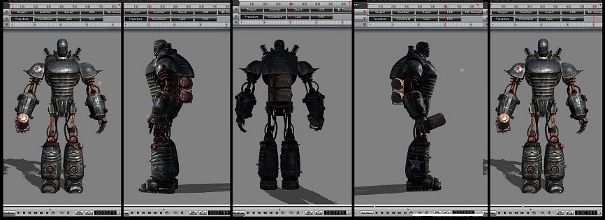

By Dragonskunk - 11 Years Ago
Just using what I learned.
The camera is parented to the blue sphere which is normally invisible. I didn't want to use 'look at' as I wanted the camera to have a more natural motion.
I would have even more control if I parented the blue sphere to another shape using just one for rotation and the other just for translation offering separate transform keyframes.

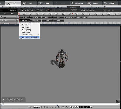

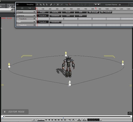

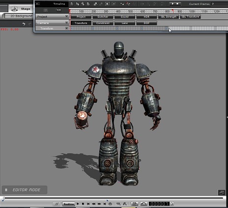

By Peter Blood - 11 Years Ago
Hi guys: :)
Busting your nads trying to get a pre-made path into position??? ;) Fugetaboutit. :P
Here's a technique I picked up from justaviking. :w00t: (Thanks man, this has made path making a breeze. :D )
First, scrub along the timeline changing your camera position at whatever intervals you desire. I changed position every 200 frames in the example below.
Then pick a point just in front of the first timeline marker, left click and drag, holding it until all of the markers have been included in the shaded area.
Right click on the first position and choose "Convert position to path".
BADA BING, you have your path with markers at every camera position you noted and at the height and location desired. Edit path as necessary to fit your needs. (make more round, add a dummy etc.)
